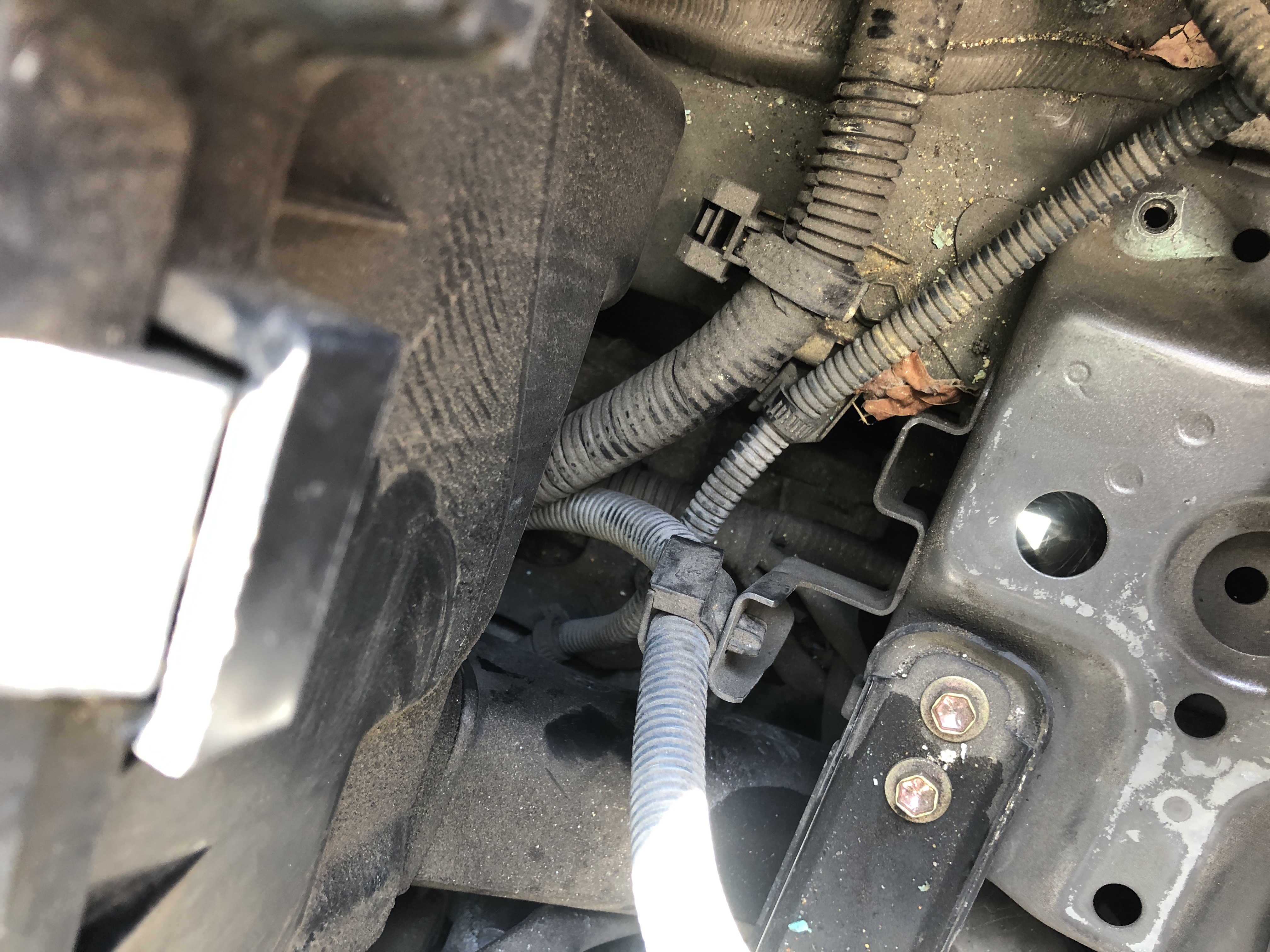

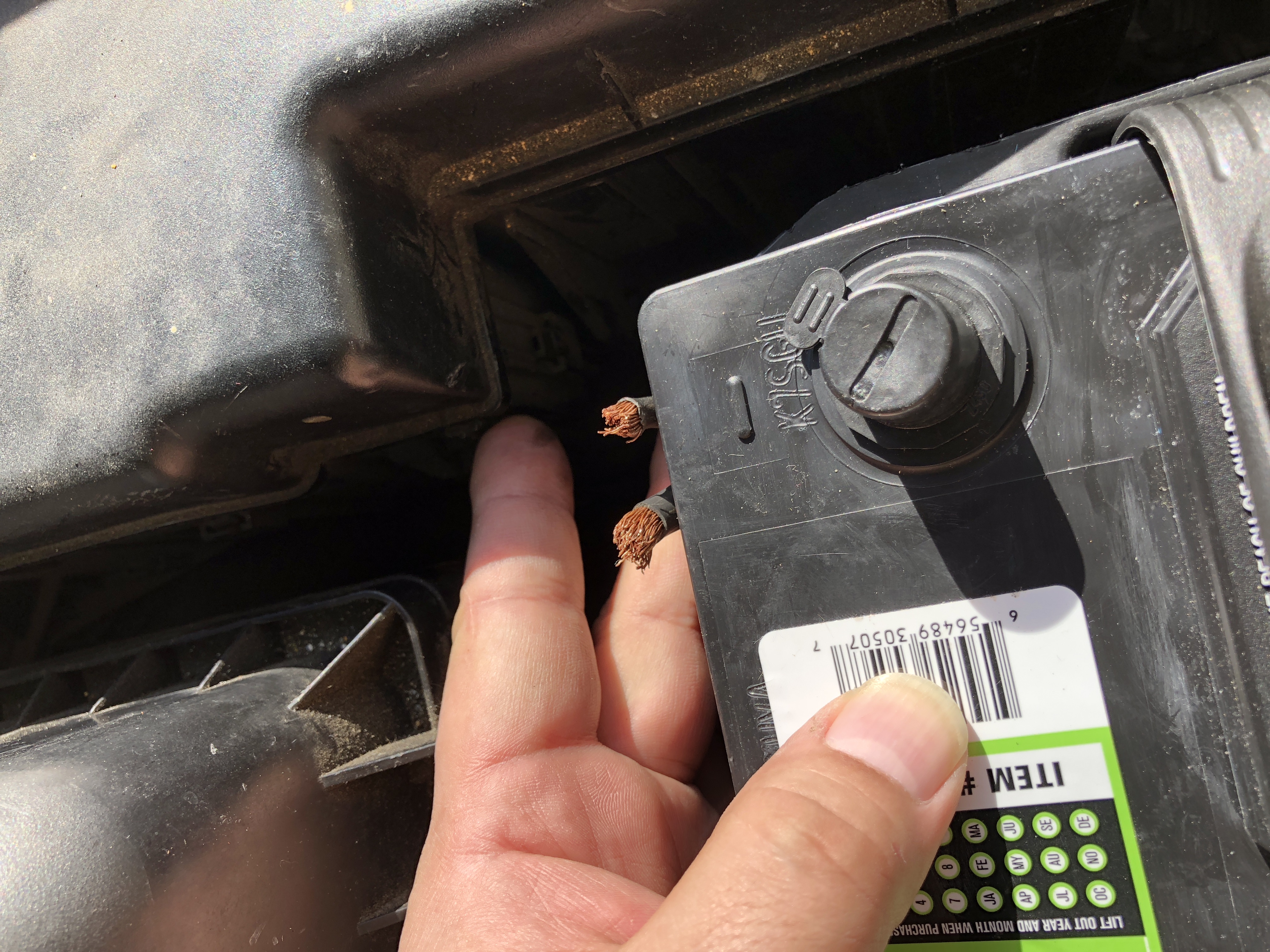

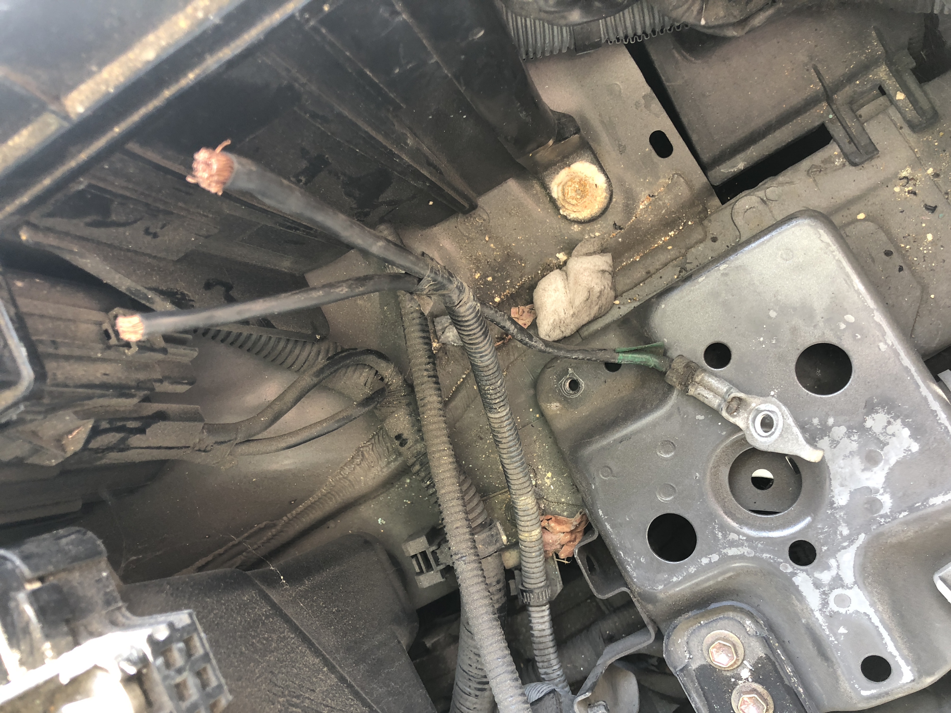

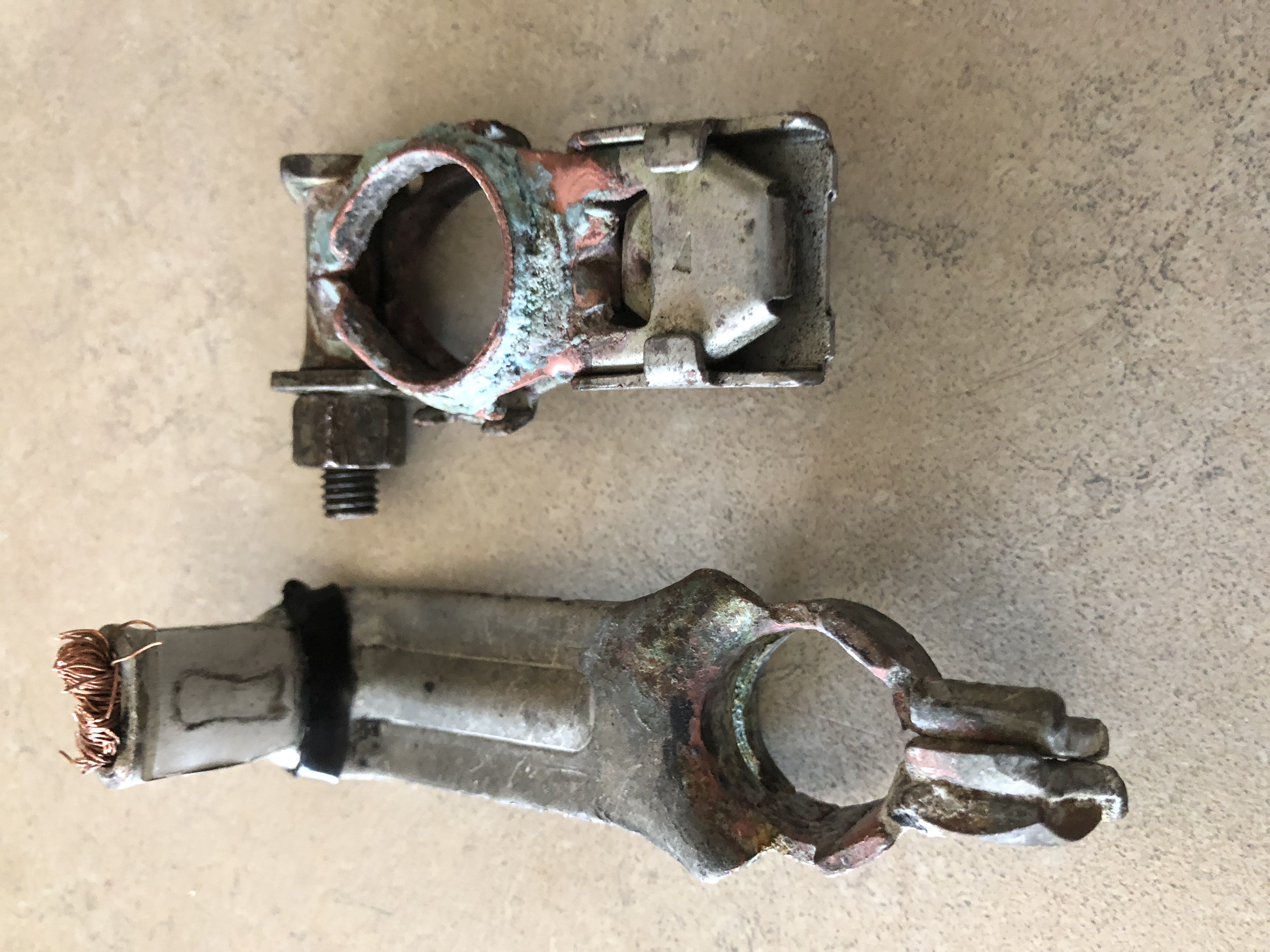

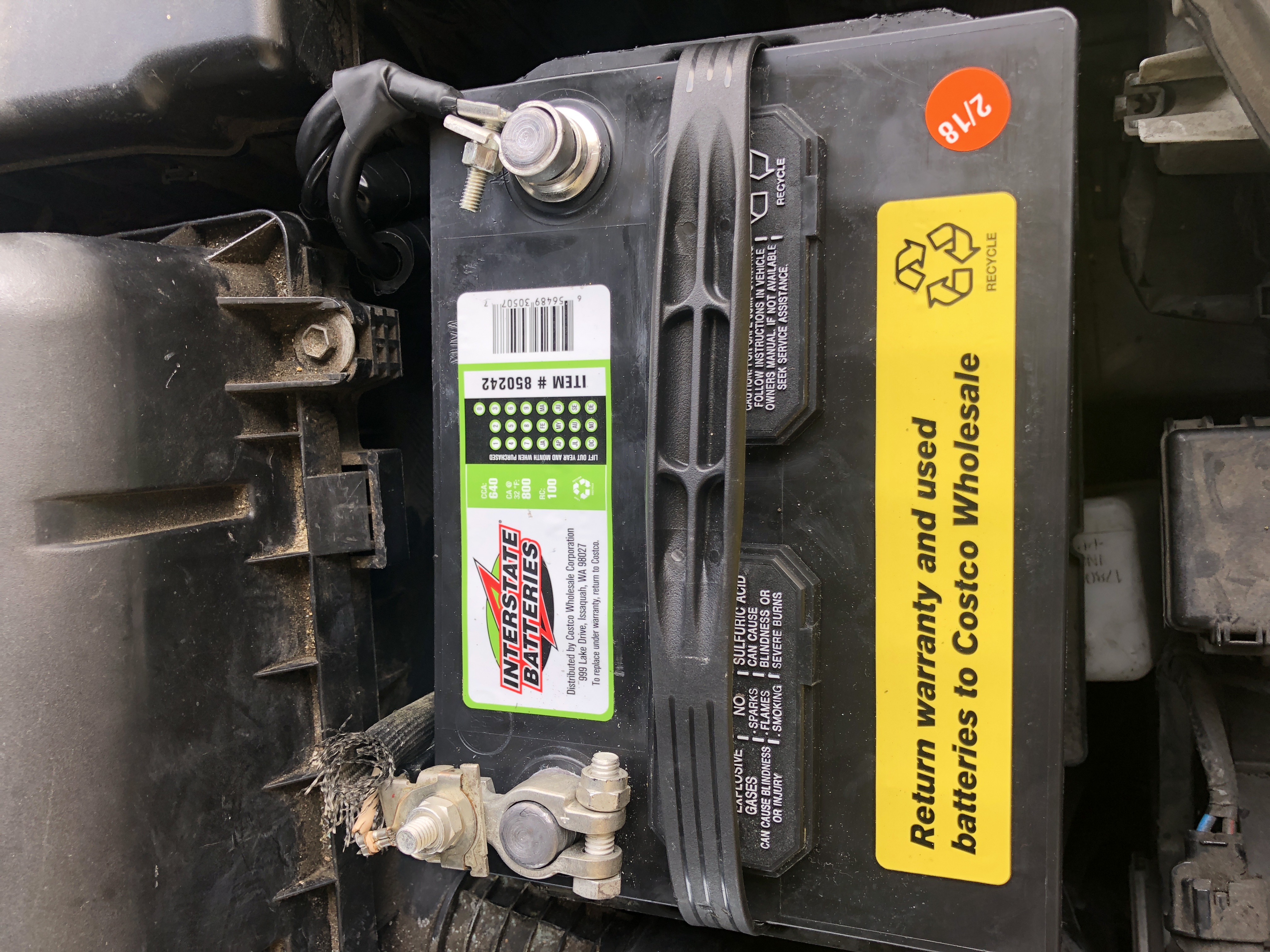

I confirmed a new battery was needed, upon further inspection of the battery terminal connections, I decided to replace them, however I cut the negative terminal off and now with my new replacement connectors the negative cable is too short. I went to interstate battery store and they advised me to replace the cable, or connect the cable somewhere else on the chassis.
The negative battery cable cable splits in two, I have easy access to one end, however the second cable snakes into the engine compartment and I can see where it’s connected to on the chassis, but not sure I can access it, even if I could I’m not sure I have the right parts to remove it, let alone reconnect it...pics attached...
A few ideas:
Can you remove any chassis cable plastic hold downs for the negative cables to allow more cable free play? More free play that will allow more free cable at their ends to connect to a new battery terminal. Then bolt the bare cables to a new terminal? See link below:
https://www.google.com/search?ei=X9W....0.eQ2O4jCnhUU
Or find a suitable new negative battery cable (perhaps with two cables) and splice into the chassis wiring. Cut the chassis cable back to not have the splice joint extremely close to the battery. This to allow the now spliced cable to easily bend to attach to the battery.
There are copper "barrel" electrical splices that crimp to the bare wire. There is a special tool to crimp them but vice grips should work. If you have a small propane torch solder after crimping for a better electrical connection. See link below:
https://www.google.com/search?q=elec...hrome&ie=UTF-8
Or use something like a split bolt connector that would clamp all bare ends of all cables together. See link below:
Split Bolt | Copper #10 - #6GA | S6 | ElecDirect
Or cut the two chassis cable back and install one copper eyelet terminal on both of them. See link below. Then bolt this eyelet terminal to the one on the new battery cable terminal. If having a propane torch solder after crimping or can just solder.
https://www.google.com/search?q=copp...hrome&ie=UTF-8
After splicing/connecting to the new battery cable. Cover the splice with electrical tape. Hardware stores sell split plastic wire protector that goes around the wire to hide new cable and splice.
Clean any bare copper wiring to shining new prior to connection or soldering.
If soldering use only rosin core solder. Tin the cable ends before doing the final solder connection to the other cables or connector.
The split bolt connector is the easiest to use. Decent hardware stores should stock them. Get the size the fits the diameter of the copper wires.

I bought a battery harness splice kit and replaced the corroded terminals, parts cost less than $25, available at your local auto parts store,. East Penn manufacturing has a great how to video on YouTube.
I installed the new battery, interstate (group 35, Fit 3)(Costco) $82 out the door with old battery swap. Checked the connection and had solid power.
Got inside the Camry, no key in ignition, the light was solid.
I put the master key in the ignition and the security light started blinking.
I turned the key to on position, light still blinking.
1st attempt to turn engine over and Abracadabra Alakazam, the engine turned over and started!
1st time just shy of 11 months. I should have done this after I purchased the 1st ECM off eBay and programmed it. Possibly could have saved myself $550.00, but that's neither here nor there, the Camry is up and running g and I'm a happy Camry owner On the Road Again!

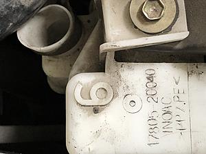

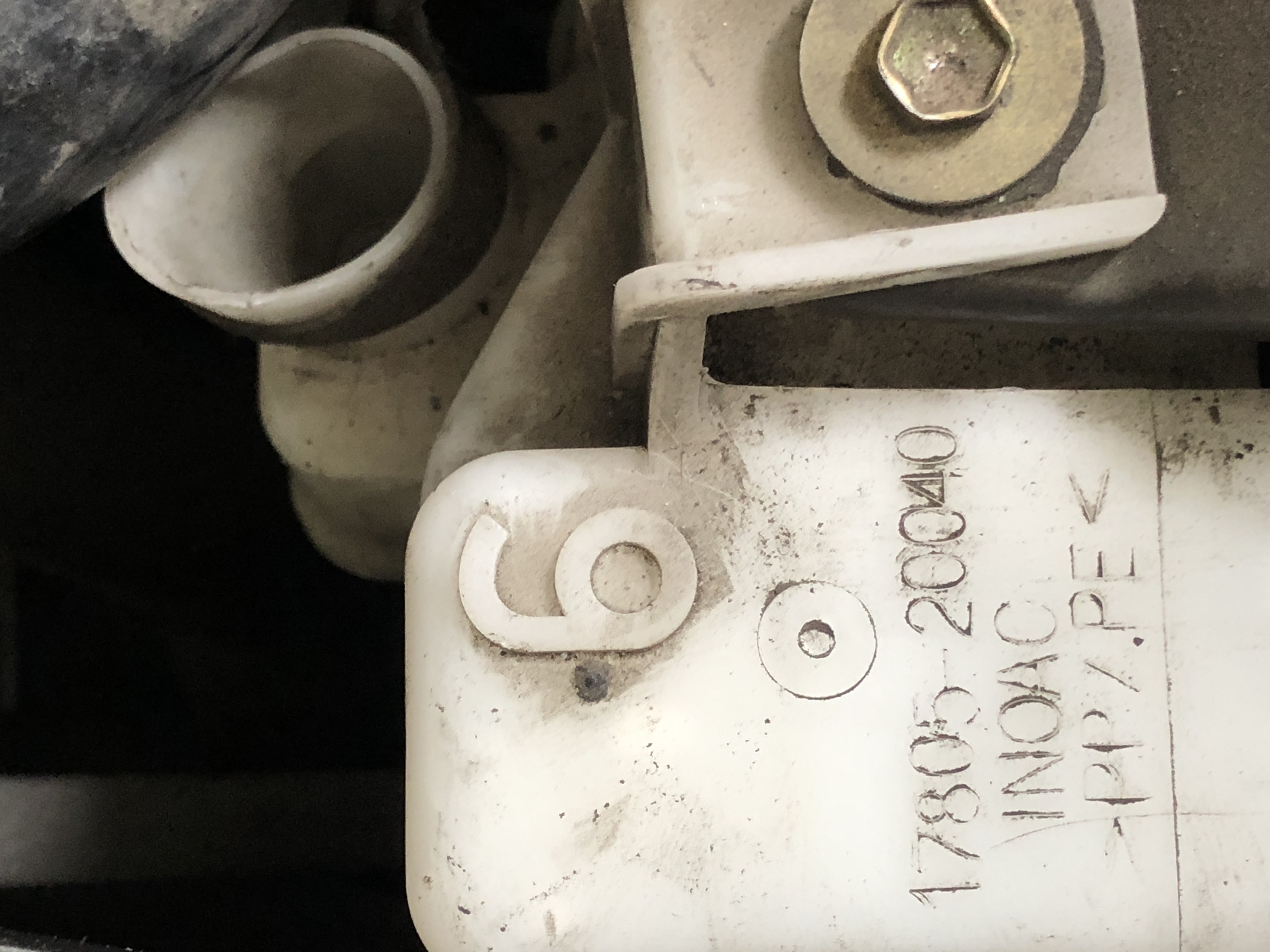

Now I just have to figure out what this part is (17805-20040 INOAC PP/PE) seems to be a reservoir that's disconnected...
Congrats on your success, great job!
The part number listed comes back as an air intake cleaner box resonator. Is the box the same as below:
https://www.ebay.com/itm/02-03-04-05...-/251475670784
If so, its supposed to connect to the engine intake pipe. The purpose is to lower any intake air resonance noise.
Does the air filter have an intake pipe that runs to the front of the chassis?
