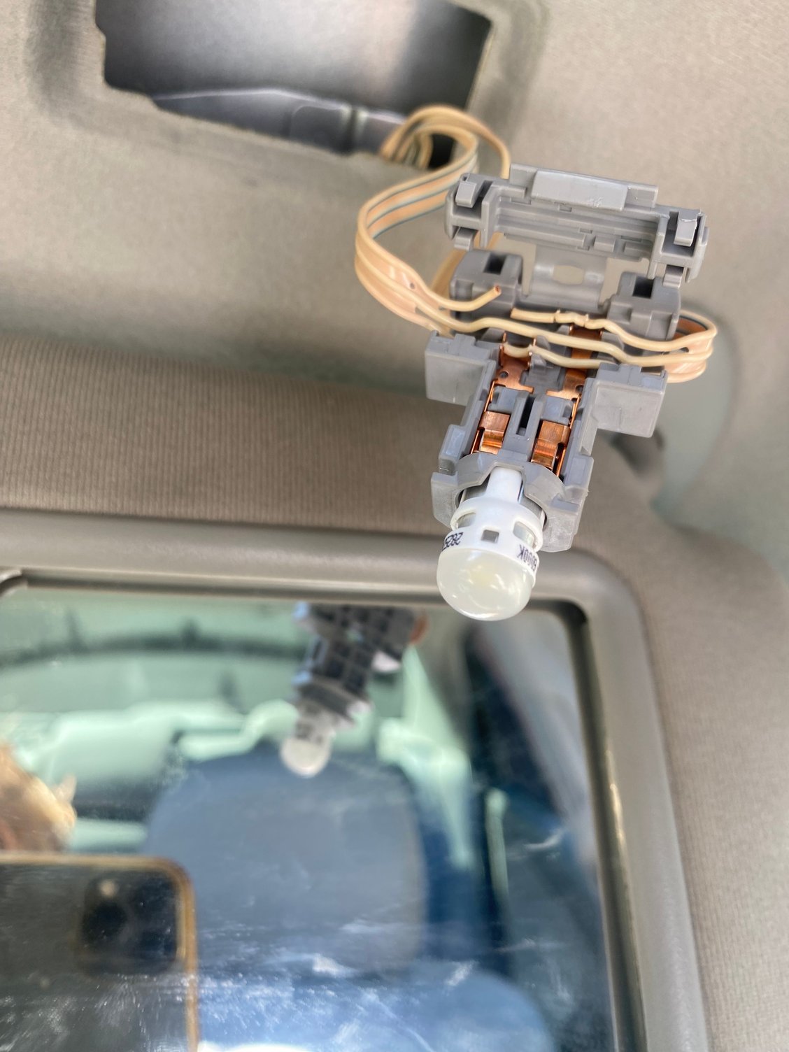

Ok so had to replace the bulb thought it was burnt out turns out the wire is cut I have never done anything with wiring is this going to be a big issue if so I need some suggestions?

Search the internet for "automotive wire butt connector." Most times a crimped connector is used such as below:
https://www.harborfreight.com/305-pi...iABEgJi_fD_BwE
Auto parts stores will also have splice connectors.
When deciding on what to use first determine if the spice connector will not interfere with whatever it is used on. If connector space is tight perhaps can solder the two wire back together the cover with "shrink-a-tube.
