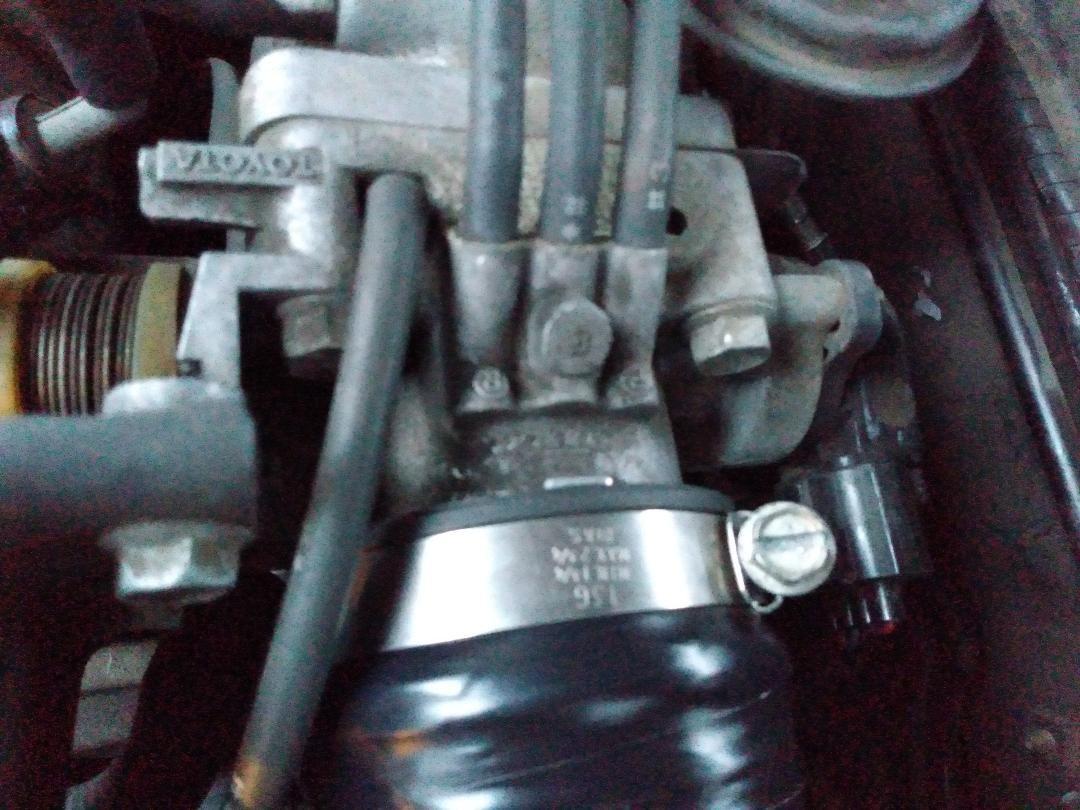

I watched several YouTube videos and yesterday I cleaned the Throttle Position Sensor but the 'photo below maybe shows not much build-up...or IS that quite a bit of build-up? However when removing the rubber hose to the TPS it was torn / ripped almost all the way around where it connects to the metal engine part. I fixed that with electrical tape (for now) and there is a nice difference thankfully and idling is not as rough but not smooth enough either.
I have two questions please:
1) Regarding the picture of my air intake hose that was cracked, fixed and pushed back in place, I can't remember whether the rubber hose should be pushed over (past) the metal lip or just to it as I have it ...or doesn't it matter and it's OK as is?

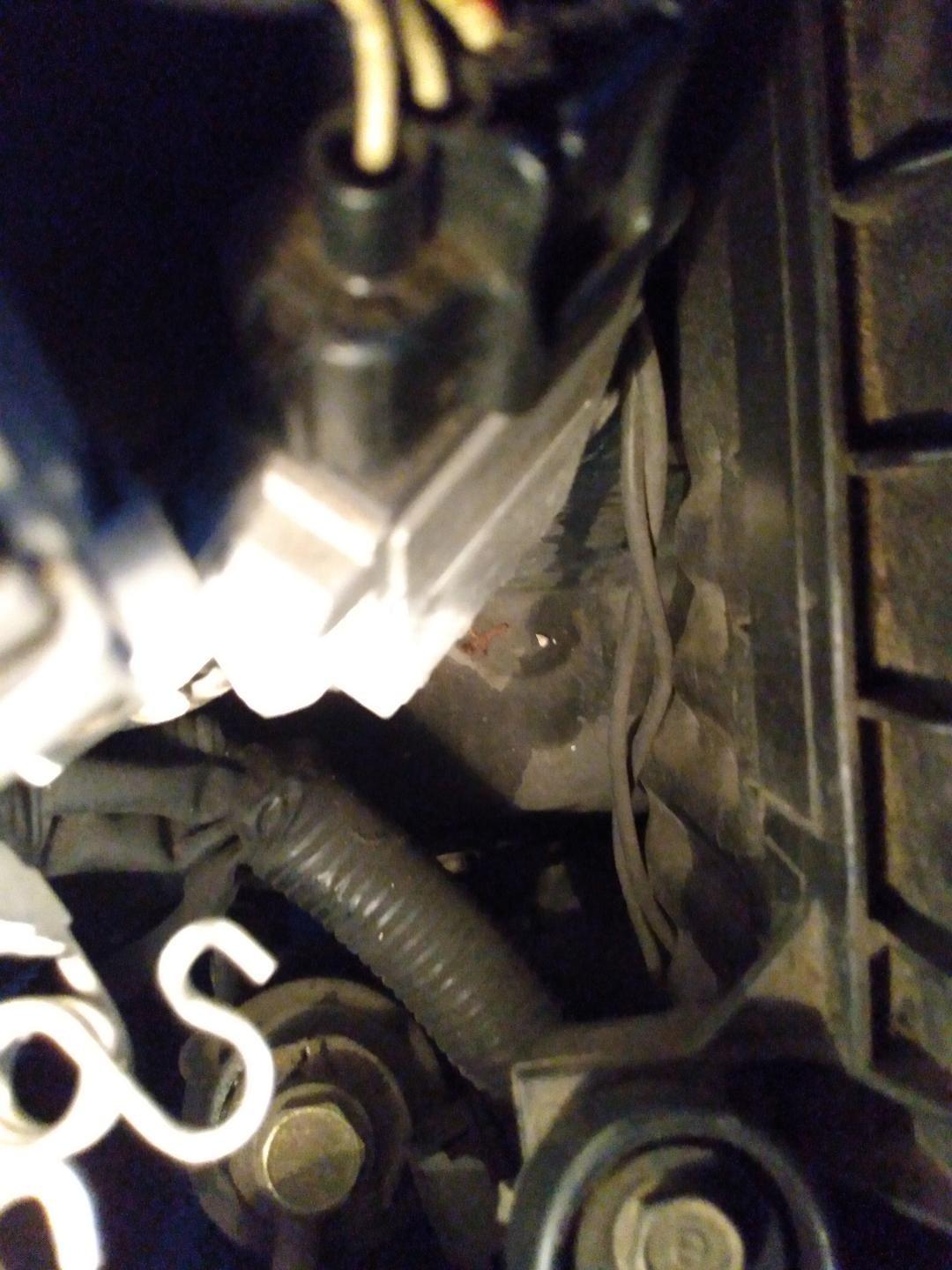

2) Is the other picture added here of my MAF sensor? Since I'm not sure and they seem to be in different areas on Camry models I wanted to make sure. My 'photo possibly shows it located on the drivers side metal inside wall. The picture is not too clear as it was getting dark.

The 6 cylinder engine has a MAF. The location is between the air filter box and engine intake. One can try to clean the MAF. The internet will have posts. If the ign key is off the MAF should not have any electrical power. Just disconnect the electrical plug to it.
The 4 cylinder has a MAP. Follow the small hoses shown in the photo to find the one that goes to small plastic box mounted on the firewall having a wiring connection plug to it. You should be able to see the hose and box easily from above the engine. Don't try to clean the MAP and they seldom fail.

The intake hose installation looks OK. The outer each of the throttle body barrel would have a ring the hose slides over. The metal tab shown stops the hose and the clamp keeps it attached.
Might research cleaning the Air Idle Control valve which controls idle. Use a solvent spray that is safe for plastics as the valve is plastic.

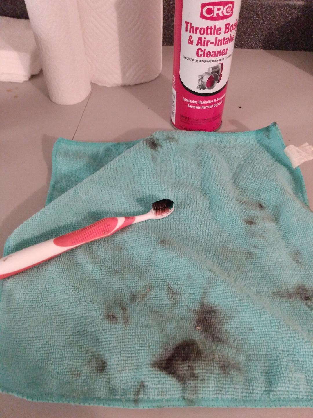

According to two YouTube videos that's all that's needed, although another suggested taking off the middle of three rubber hoses beneath all of that so the Carb cleaner which he used, wouldn't go into the engine.
The spray can pictured in my 'photo is 'CRC Throttle Body & Air-Intake Cleaner', and this is what other Youtubers used so it would seem to be safe for that AIC plastic valve.
The YouTube video mentions the car might hesitate starting after that but to keep trying for just a few seconds each time or give extra gas.

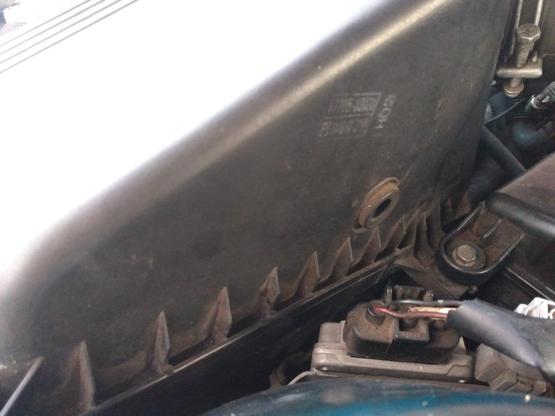

Default Air filter housing box hole.
Thank you for all your help, the Camry is running better now after sealing up the hose rips but not that smooth yet but I wondered:
I just noticed that looking from the back side of my air filter housing box I see a circular hole (obviously letting air in) and wondered - should there be a plug over this to stop air getting in from there? Wouldn't it make sense that this hole could contribute to some rough idling?
Please offer your opinion once you have time.
Many thanks, Kevin.
Pictures added.

The hole might be where the air intake temperature sensor plugs into the box. Its a plastic probe connected to a wiring harness. See link. Look for this item-it just plugs in by hand only.

Amazing! I just went out with a flashlight and eventually located it! Thank you again, what a find.
Maybe it'll help with the smoothing out since I checked the rest of the small hoses all over and found no tears or splits.

The temp sensor measures intake air temp to adjust fuel/air ratio. The engine might run better now with improved MPG.
