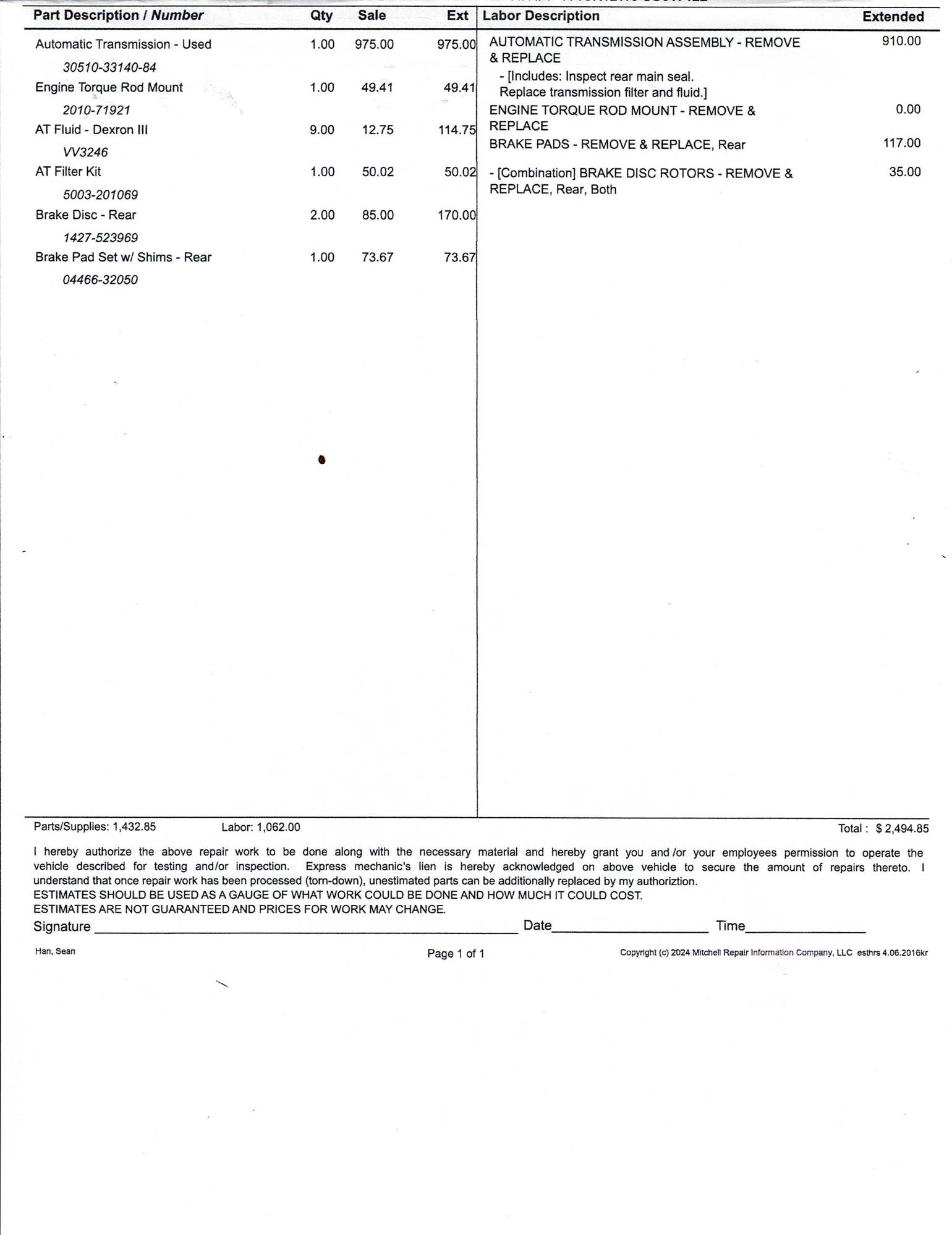

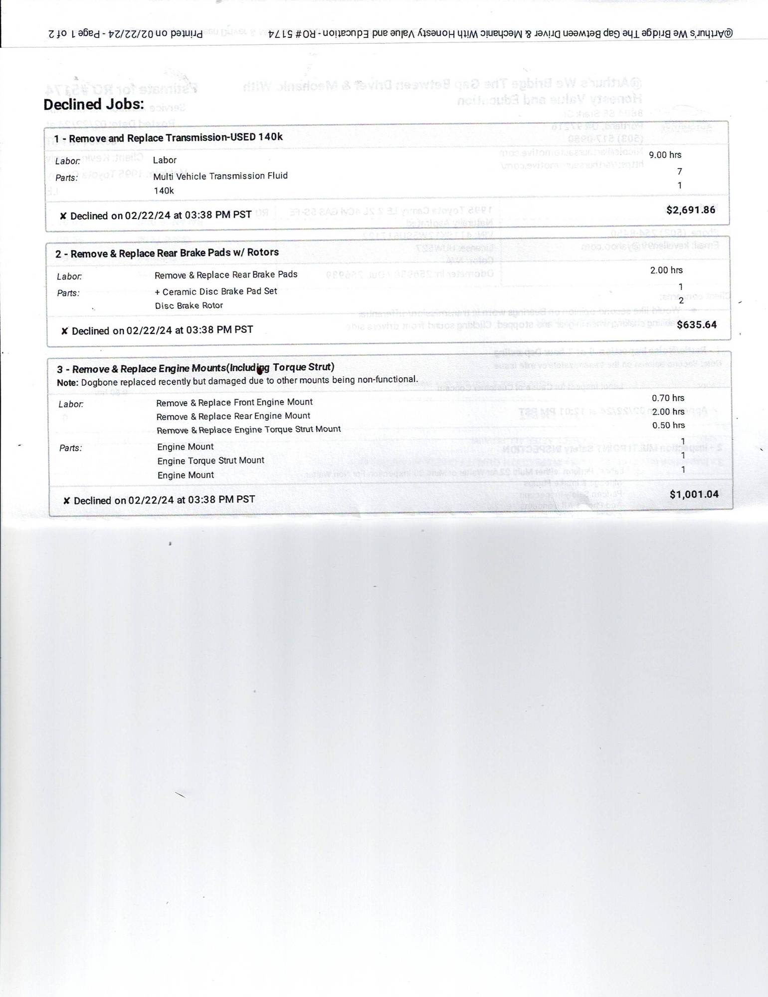

Just for a sense of comparison I have attached the only two estimates from yesterday with huge varying prices! At the place with this highest I heard the mechanic tell someone ' We'll be able to get a transmission for about $4 to 500", but that's not what the estimate they sent me says. On top of all projected costs they said I have a small drip in the oil pan gasket and they'll fix it for $622.75!
The second estimate is from a local Japanese 'Auto Clinic' and their prices are much more reasonable. I did question why they were offering a comparable / compatible transmission with only 50.000 miles and this is their response ... "In Japan, due to the restricted emission regulations, most of the people don't keep their vehicles too long like we do here". They would also check ALL motor mounts at the time.

There is going to be a large variation in trans price between used and rebuilt. These days, labor rates per a specific job are taken from a book generated by a third party. Your invoice shows “Mitchell” at the bottom. Mitchell has formulated the time in hours or fraction of to do various repair and maintenance jobs. They sell this info to shops on paper or computer software. A specific shop having the software then imputes the rate THEY charge for labor, plus local sales tax, any other fees/costs, etc. When customer asks for a quote for doing work the shop just inputs the specific work needed in detail to generate a $$ quote. Thus your quote has a price for each part replaced such each engine mount and trans item plus fluid cost.
Did you ask for quote on every item on the list such as brakes, engine mount, etc?
You can ask why the quote trans price is higher then $4-500. That price may be the trans wholesale cost to a repair shop or the shop is marking the price they paid for the trans up. A shop buys their parts for $XX cost and charges the customer $YY. This is standard practice in every industry not just automobiles and not something devious.

What is up with the rear brakes again? The quote is very expensive for the listed work.
Do you have any auto repair skills, interest in learning who to repair, etc. Brake repair is easy enough and pads and rotors low cost.
What is the hourly rate for the shop listing the quote ($85/hr)?
For the oil pan leak one might try to tighten the bolts but don’t overdo it or they can break. You are going to run into this type of high repair charge for seemingly minor issues as that is the way it is for repair shops. That’s way many people DIY on repairs and buy their own parts.
