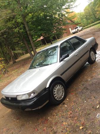

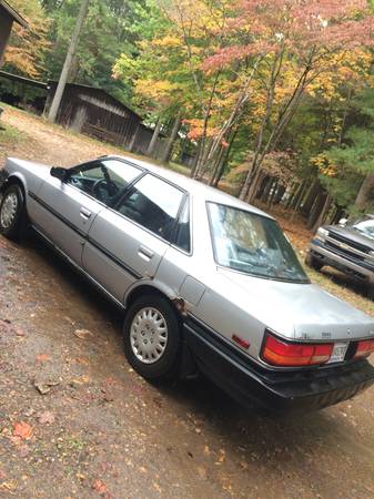

So, I started digging for a beater to drive in the winter. I was originally looking for a truck, but stumbled across this ad on Craigslist for a 1990 Camry. I almost glossed over it because people in my area have a habit of using "keywords" sections in their ad of stuff that is completely unrelated. But I noticed in the title that it was all wheel drive. I thought "eh, I'll look at it...It is a Toyota." And as it turns out, it is in great shape, relatively low miles, and minimal rust (or so he says, no pics under the car). Then I started digging, and found that these are both reliable and rare. I've attached a couple pictures from the listing on CL.
I'm getting my cash together and going to look at it tonight, and would like to know what to look for as far as things that can cause me big problems/repair bills later on. I'm comfortable with working on anything, but only if the price is right.
So, any suggestions on what to look for on the v20 Camry AllTrac? I mean specifically as far as abuse, noises, etc. outside the normal realm? What commonly breaks?

Well, I just got home with the new Camry. It drove great on the 100 mile trip. Turns out it is a 2 owner car, and the 2 owners are related.
Beyond what was in the picture on the rear fender & the muffler, there as no rust. There was a "clunk" in the drive line that turned out to be the rear diff bushing. It does have some minor high speed vibration, probably tires out of balance from sitting or age. Pulls a tiny bit to the left. Either mismatched tires or alignment could be to blame. A couple tires are older, but still have plenty of tread. I was planning on getting a good set of snow tires on it anyway. On the way home, I rolled a couple windows down to let the "car that has been sitting" smell out, and they wouldn't go back up. I shut the car off at KFC where we stopped for dinner, turned the ignition back on, and the windows all worked again. So there's some gremlin there, maybe a circuit breaker or something? Also, the speedo doesn't work. He said it worked before they did the timing belt & water pump, so they either forgot to plug something in or busted the sensor.
There was only one major issue. The syncro for 4th gear is pretty crunchy, so I may have to split the transmission open before winter to replace it. At which point I'll probably go ahead and do a full rebuild (all syncros, bushings, bearings, whatever). Or I'll just shift it carefully, as doing so keeps it from crunching.
That's really all that was wrong with it. Interior is really clean, dashboard is in great shape, everything is intact. The engine sounds really tight. No piston slap or valvetrain noise. That was expected, though. Body is totally straight save for the little bit of rust and faded paint.
The car rode like a dream. Suspension was perfect over every bump. I got to test it on a lot of them. The roads going to the owners house was paved, then chip and seal, then gravel, then dirt, then rutted dirt. The only reason I knew I was still on a road was because of the GPS. I had to drive it 10 miles out to get to a road where I could get up to highway speed...
In the end, I wound up getting the car for $1,150. Considering I don't need to do anything to get around in it but put a plate on it, I think I did pretty good...
