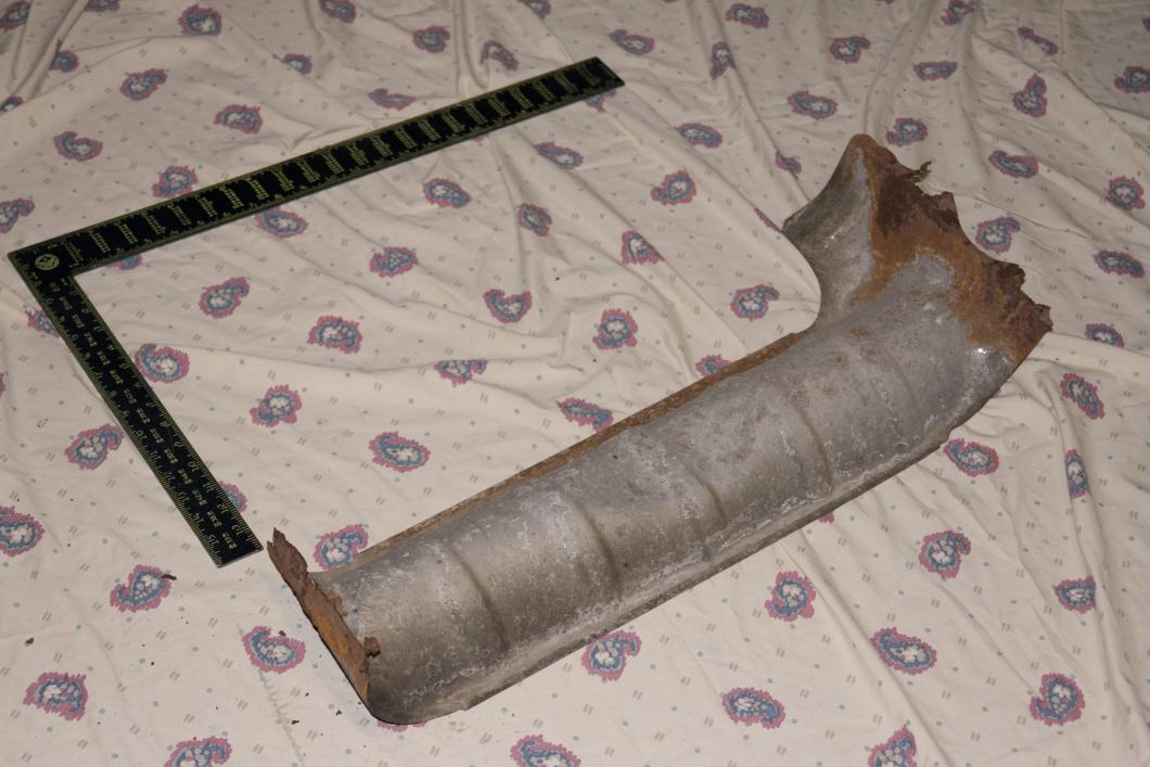

My son was driving his 96 Camry and hear scraping and the following was under his car....
The question is ..does this belong to his Camry .. OR ..was it just on the road and his car somehow caught it ?
Thanks for your help
oh..if it belows to car what is it and is it needed ?
Old Feb 25, 2013 | 10:54 AM
Might be a section of heat insulator for the exhaust system.
The exhaust system has many heat insulators (heat shields) going between the exhaust system components such as emissions convertor(s), exhaust pipe, muffler and chassis floor to keep it the floor from getting too hot.
Look under the car chassis at the exhaust system. Compare the part you have to the exhaust system layout and determine where it may fit.
Given the 90 degree bend of the part at one end, guessing the part may go on top of the section of exhaust pipe located rear converter under the chassis but before the last muffler near the tail pipe. The 90 bend of the part being oriented toward the muffler.
Remember the shied goes on top of the exhaust system with the "U" shaped portion oriented down to surround the upper half of the exhaust component.

thanks for feedback... I will jack up car this weekend and try and match up.
