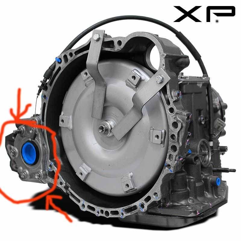

The plate/bracket to which I am referring in the above prior post is circled here.

Alignment pins in the carrier bearing mount/engine interface found! Went ahead and tried pulling off the tranny with the axle still inserted. It came out ok. Have to do something about the stuck carrier bearing. I could reinstall the tranny and then cut/pull the alignment pins so I can put the whole passenger half axle/carrier bearing stuck in mount unit back in.
Thanks for your help toyomoho. We'll see how much fun I have putting it all back together after I get the seals replaced.
