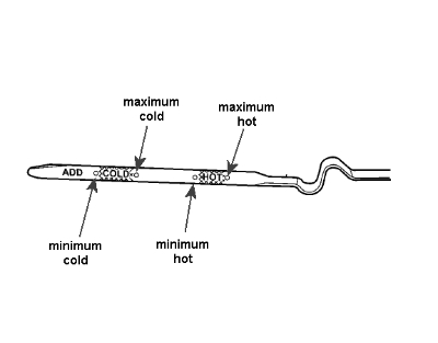

ok thanks, but about those sticks, every time from the first check, there is always fluid on the stick which makes it hard to get a reading, there is a line like where it starts the dry part but that's hard to tell because it always got fluid on it but not completely covered like the lower part of the stick where the cold mark is, but I will check again in the morning.
Old Oct 1, 2016 | 07:50 PM
dirty hands's Avatar
Joined: Jan 2014
Posts: 543
From: Ipswich QLD australia
wipe off the oil on the dip stick every time before a dipping then read
wipe off.. dip ... read .. wipe off ..
hope that helps
Attached Thumbnails drain and fill or drop the pan and change filter on the ATF pan and fluid?-trans-dip-stick-hot-cold.jpg
Old Oct 1, 2016 | 08:38 PM
indiglofish61's Avatar
Joined: Apr 2015
Posts: 68
I wipe the stick off every dip, the thing is that when i pull it out there's still fluid above the hot mark that makes it difficult for me to read. I guess there's no way to get around that, i will just try to read it the best i can. Thanks for the replies.
Old Oct 2, 2016 | 05:13 PM
Use the solid fluid line.
Too much fluid can cause issues in reading the dip stick.
Typically once all the added fluid drains out from the trans fluid tube. following Dirty Hands advice will lead to seeing an area of solid fluid on the dipstick. The end of this solid area being the level of the fluid.
