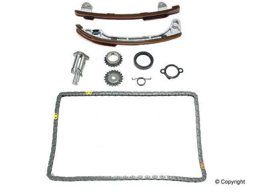

what happens is the guides wear out then the cogs and chains you can replace (its a kit )
you have done well for chains to reach 300,000 which is rare normally they are replaced at 200,000
this is the kit you need..... on ebay US $152.99
Made in Japan T031K OSK Timing Chain Kit Toyota Camry RAV4 TC Highlander Solara | eBay
this kit inlcudes oil pump US $1,111.00
01 10 2 4L Toyota Scion VVT I Engine Timing Chain Kit w Oil Pump 2AZFE | eBay
do you want to D I Y ... this is better than the repair manual .
