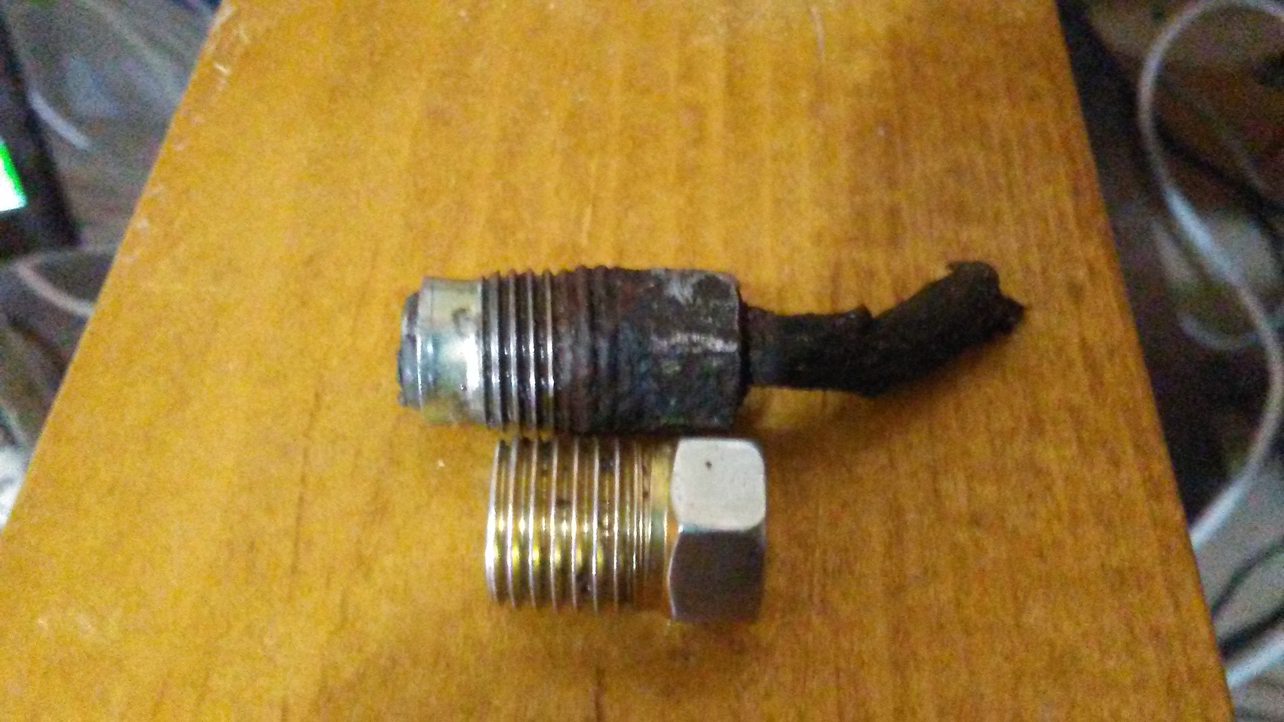

Hi. I am replacing some brake lines and noticed the "3/8-24 Inverted Flare Gold Zinc Tube Nut Fitting 3/16 Brake Line" fittings I ordered are not as long as the original ones and do not have a taper at the end of the threads(see pic).
The new ones are only 10 mm long and old ones are 15 mm. They bottom out before sealing the inside end of the joint. Anyone know where to find the 15 mm with the tapered end?
I found solution. This is it: BR170 3/8"-24 Bubble Flare Nut.......
