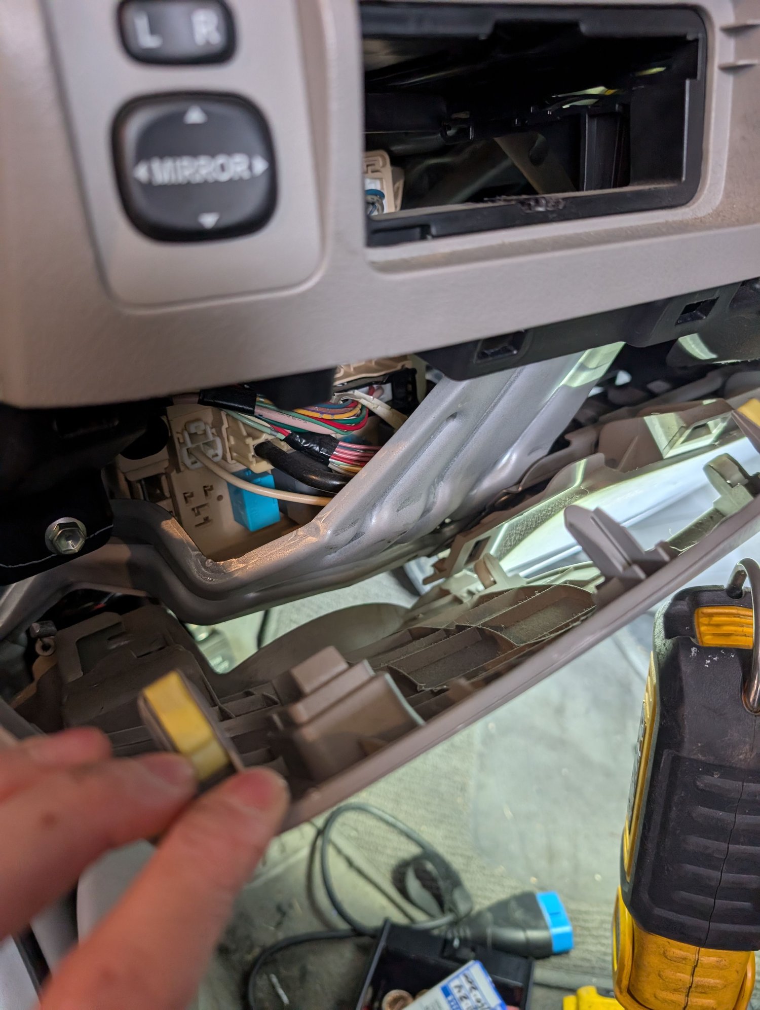

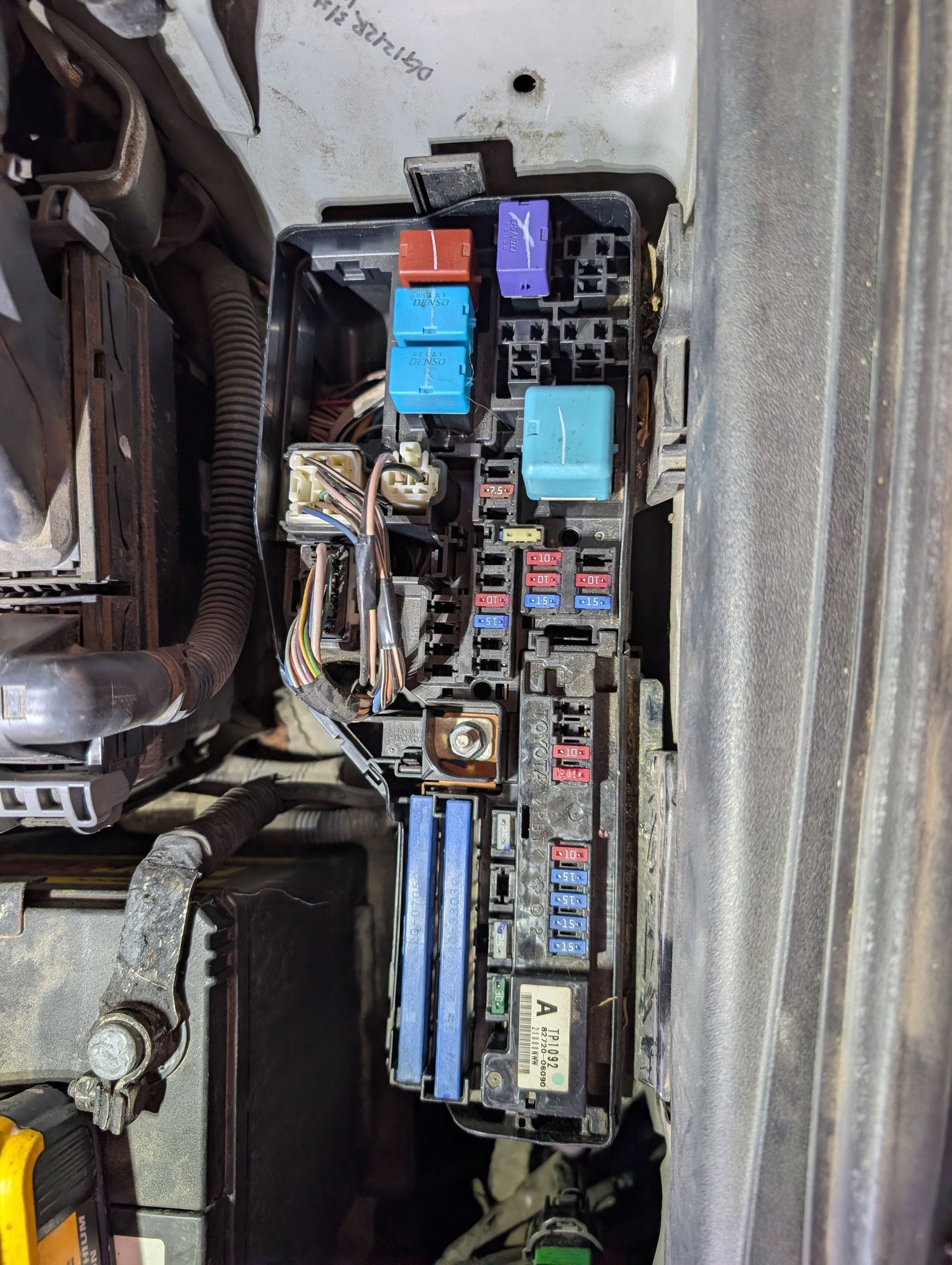

Old Feb 20, 2026 | 05:04 PM
simmion's Avatar
Joined: Feb 2026
Posts: 15
Could these be it, it was under the steering wheel. I saw this on a video for a Corolla.
Old Feb 20, 2026 | 05:39 PM
simmion's Avatar
Joined: Feb 2026
Posts: 15
I tried swapping the two blue ones also to see if that might be a quick fix. No fix.
Old Feb 27, 2026 | 11:34 PM
The fuel pump COR relay is now soldered to the circuit board.
Check fuel pressure.
Check for 12V power at fuel pump wire harness. May be gray color for power and white/black for ground.
