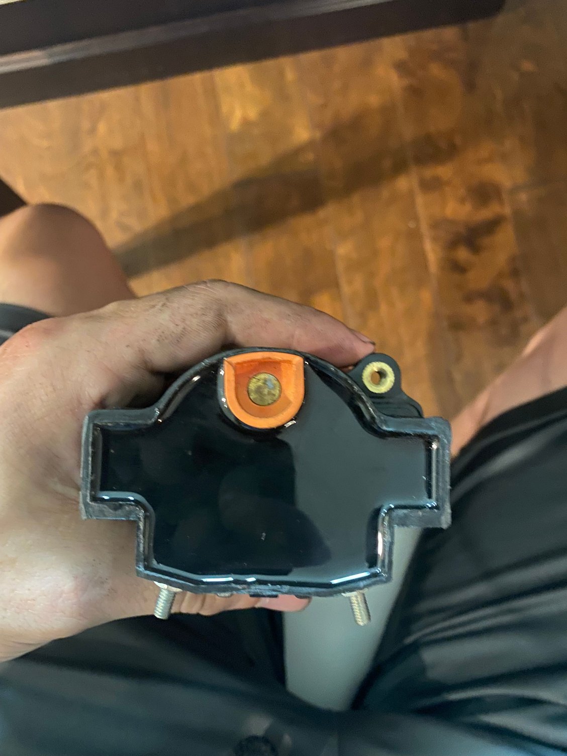

i have coil out right now. trying to figure out how to upload pic/vid. no cracks and the ohm's check out good and such. Its a new ignition coil also
