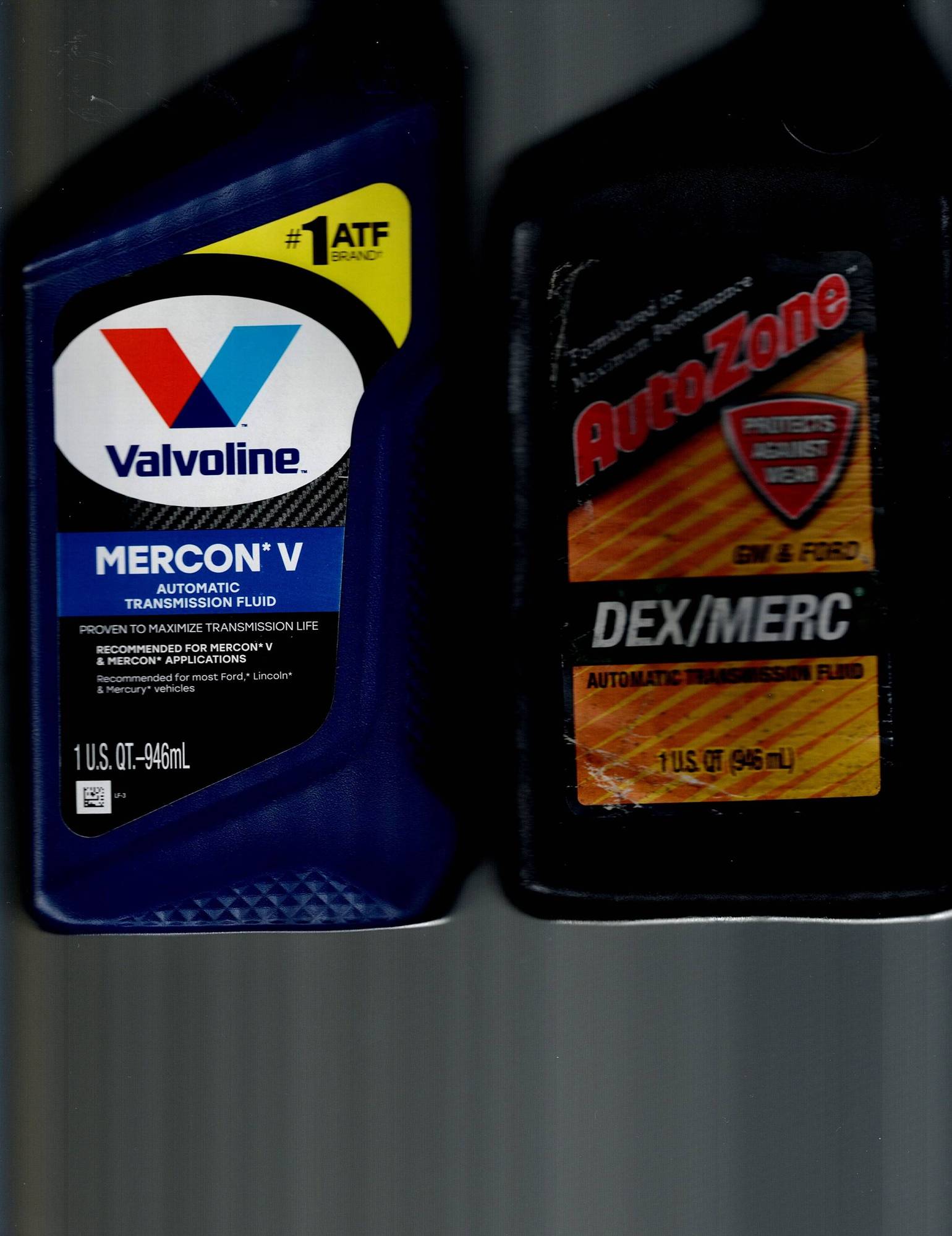

As you will know, the transmission dipstick on a 2.2L 1995 Camry says to use Dexron 11 but it's no longer available.
I have hardly ever in many years have had to top off the fluid and when I did I used the Dex / Merc shown on the right in my 'photo below, and it has not caused any issues. I am almost out of that Dex/Mec so went to Auto Zone today.
Auto Zone couldn't locate that same Dex/ Merc fluid that I've had sitting around for several years so they checked online telling me that the Valvoline (on the left in my 'photo) is the equivalent.
Both fluids shown in the 'photo state on the label they are for use in GM and Ford vehicles.

Mercon is a Ford licensed product while Dexron is a GM licensed product.Toyota used Dexron III in the 1995. GM withdrew the Dexron III licensing.
If you want a product suggest using Dexron V or VI.
There are lots of replacements for Dexron III. Some have the words “ATF” in the name. One product I use is Chevron MD-3.
