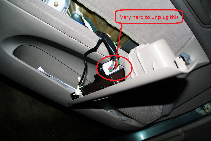

Old Aug 4, 2019 | 07:34 PM
workwork's Avatar
Joined: Jul 2019
Posts: 41
Thanks!
I tried to uninstall the power switch, but found the switch is hard to unplug. Please see the picture.
Any advise would be appreciated.
Old Aug 5, 2019 | 01:20 PM
Posts: 15,178
The plug must have a press or pull to release locking mechanism.
You can leave it plugged in the remove the door panel and work around it to move the window up.
