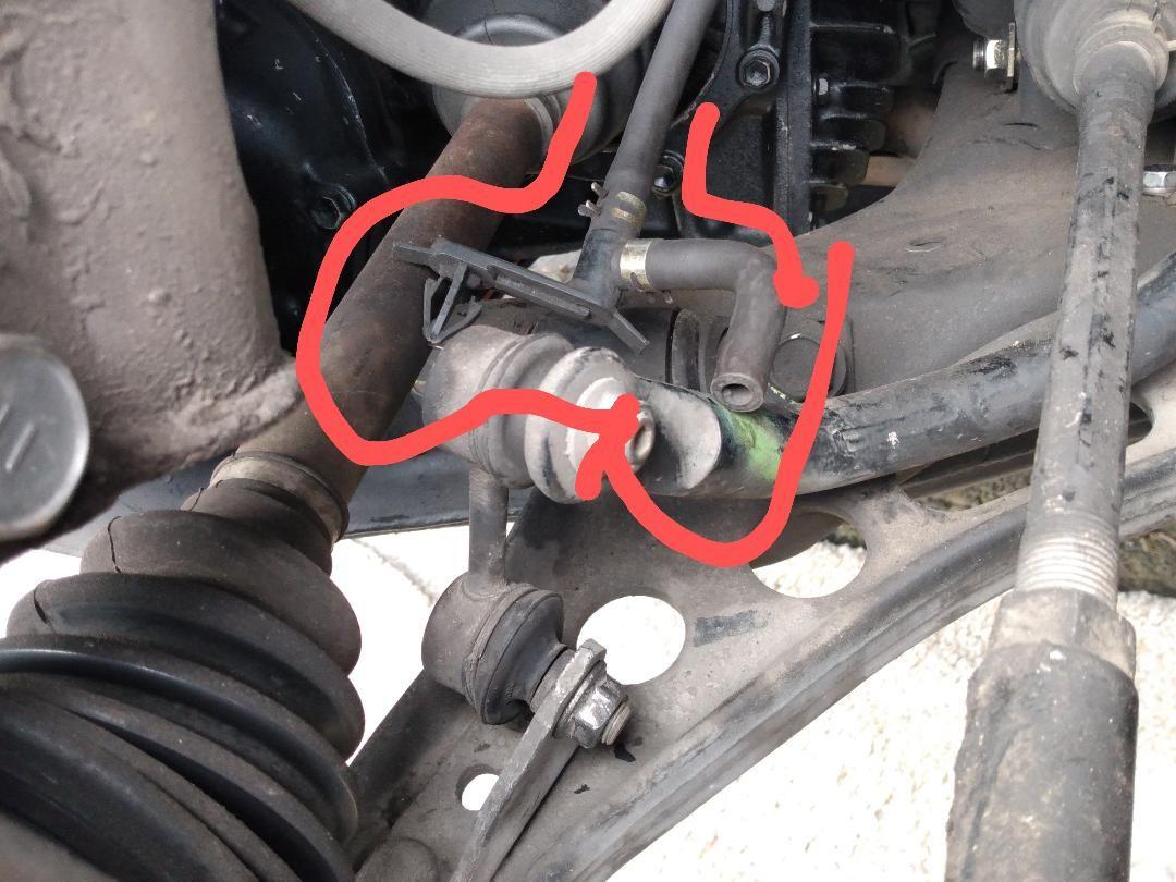

Can someone please identify this piece marked in red in the photograph that has come loose from 'somewhere' behind the front drivers side wheel. It's below the brake fluid reservoir.
I have looked for an hour and can find no place within it's length (of about 4") to attach it anywhere on the frame.
Is it an overflow type hose or does it attach to something else (the rubber end)?.
Thank you.
or any help.

Might be related to the gas tank emission system.
Is this car built to Federal or California emissions standards? There should be a sticker in the engine compartment stating which.

Just behind the front drivers wheel I found a hole on top part the metal body and that loose part I asked about 'seems' to just shove in there OK since it doesn't reach any other area with a hole. You will be correct in that it's some sort of a cylinder hose run-off hose thing.
It does seem that my Camry will be built to California emission standards. I found a site, put the vin in and got the information below which is only part of that page as it's a lot of info otherwise .....
