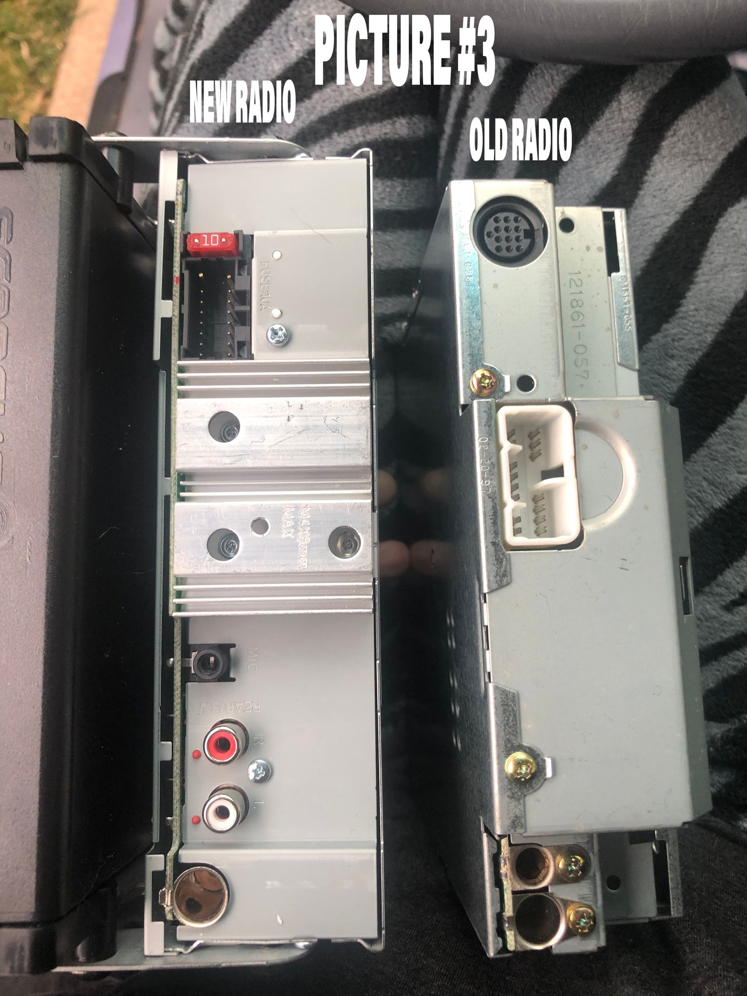

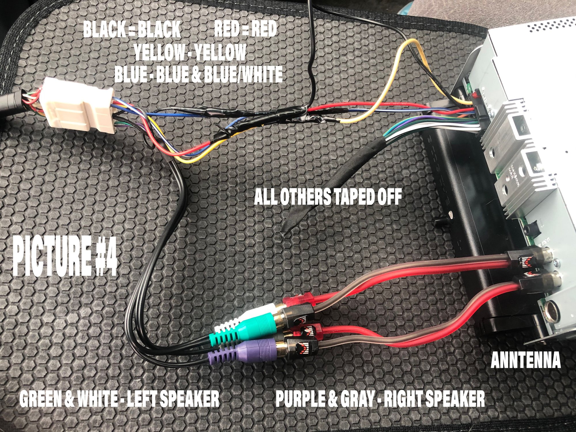

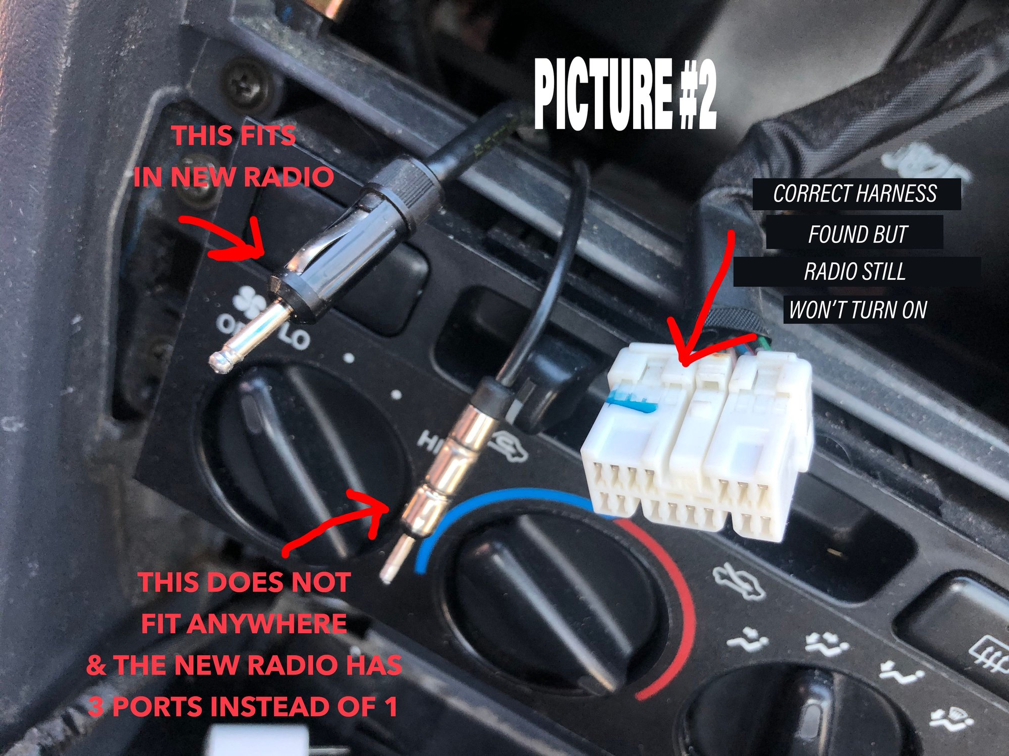

Thank you for your help, Ive attached a bunch of pictures to show what I have.
The harness with the coaxials built into the speaker wires is what fit the connector in my car so I didn't question the logic. I thought it also solved the problem of the one black cable coming from the car that doesn't fit anywhere in the new system, but nothing works.
Did the old radio work?
I am going to need to review the wiring diagram for the new radio. The old radio used a remote amp. This means the radio generated a low electrical power "speaker" signal which was sent to the amp. The amp then magnified this signal then sent it to the speakers.The old radio had 10 wires running to the amp. The amp itself has two 12v power wires running to it and the amp sends 12v to the radio to power it.
You state the white plug at the end of the chassis wiring harness is the same plug that goes into the old radio? If so post back with the colors of all that chassis wiring going to that plug.
Check the Radio No 1 and Radio No 2 fuses.
