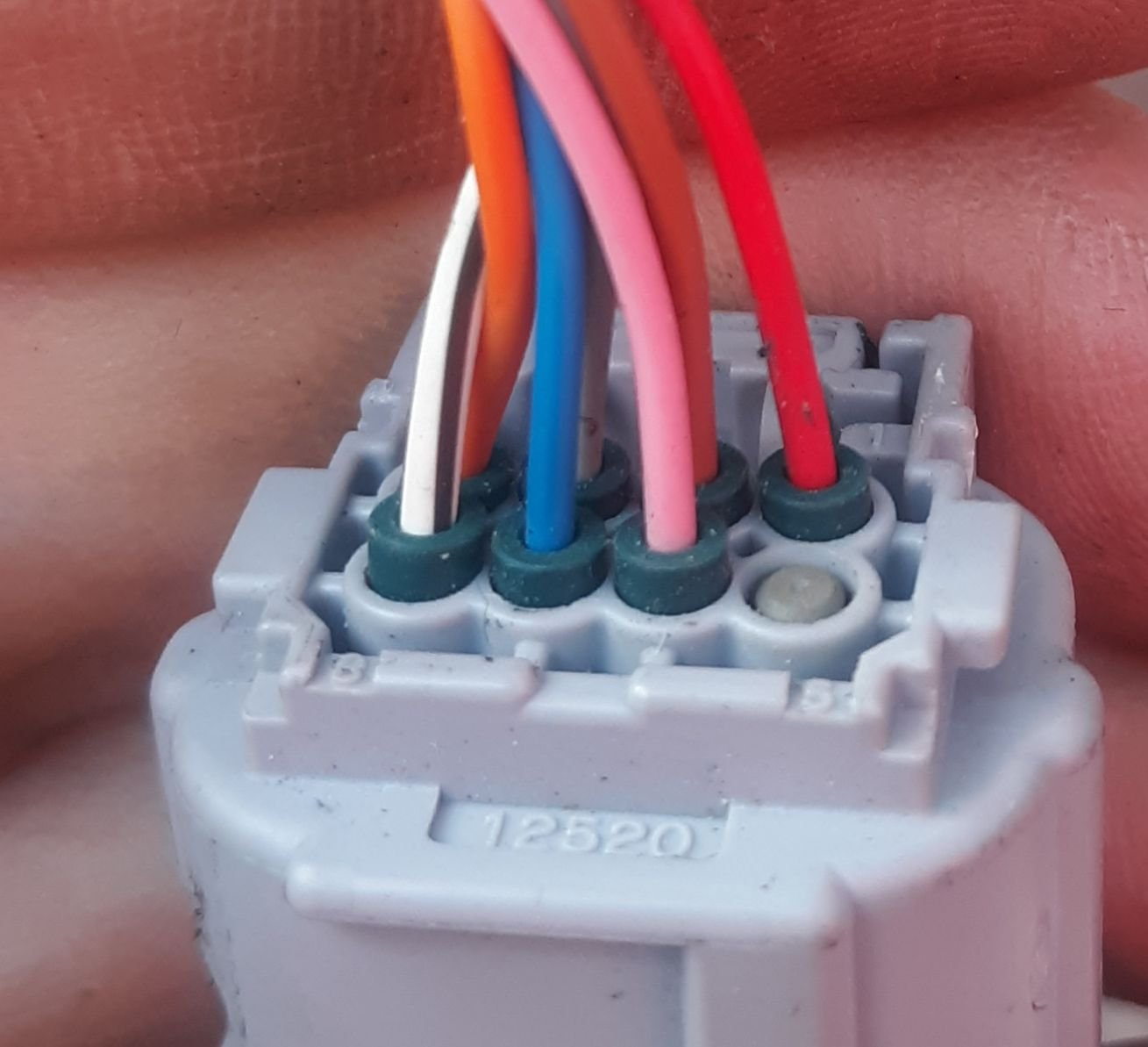

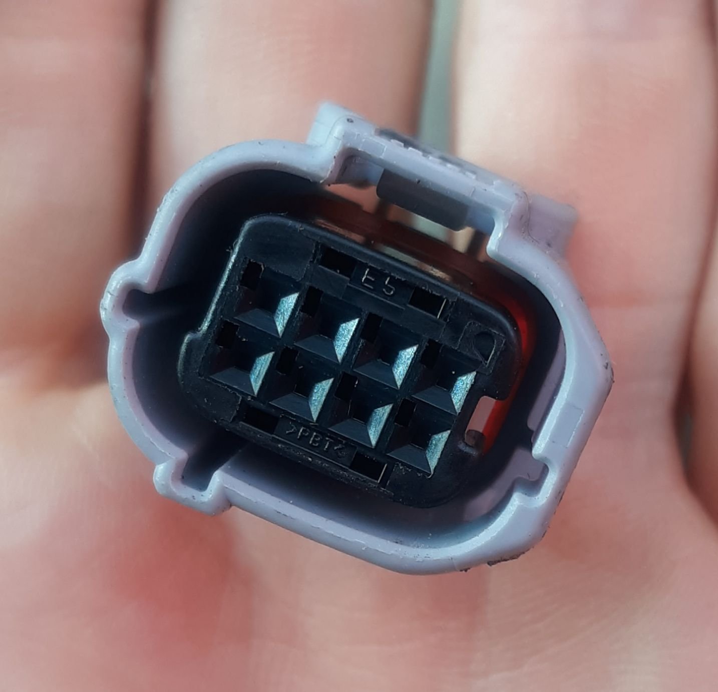

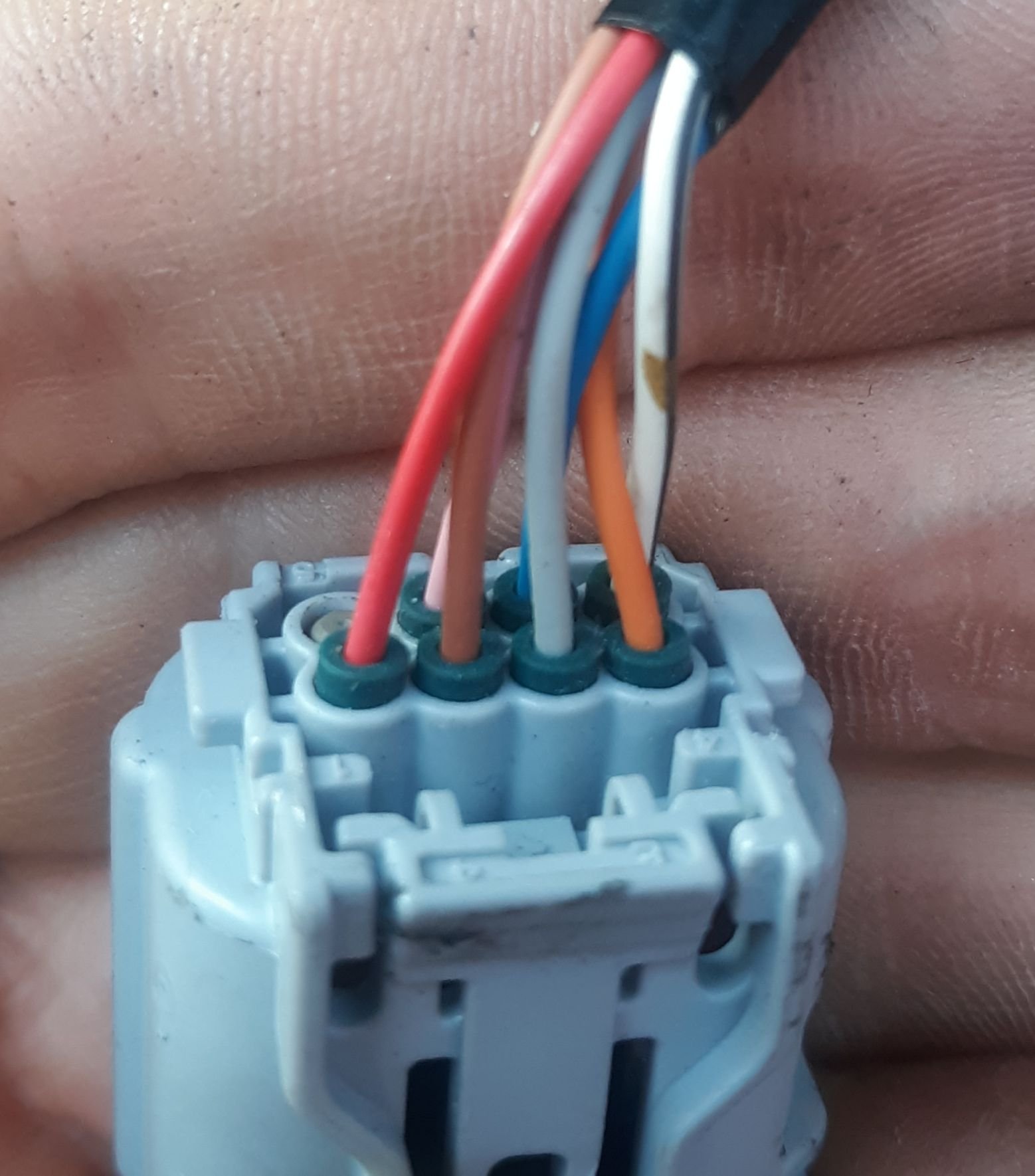

Everything ended up going ok. Everything fit, plugged in, and worked. There is something a bit out of place though, and that's an extra connector on the wiring bundle. It doesn't go to anything that I could find on either door (from donor car or repair car) and it's an 8-pin connector with one unused socket (so, 7 wires going in.)
There are some subtle differences between the two doors, and as suspected, the Japanese one has slightly better build quality.
Specifically, the door position holder between the hinges is fastened differently on the door side, but doesn't seem to be a better or worse design either way. The speaker, however, is noticeably distinct. The Japanese one weighs about twice as much with a beefier speaker magnet and is labeled with the well-known brand JBL, whereas the North American market uses an unlabeled, generic one with a tiny magnet.
A bit more of a subtle difference is with the door handle/lock cables. In the Japanese door, they have a little clip where they snap in to keep them separate and so they won't rattle inside the door. The other only has little sleeves of foam along a short length of each one.
Below, I've included close-up pictures of the mystery connector. Maybe this went to some fancy option on a higher trim level (?)
