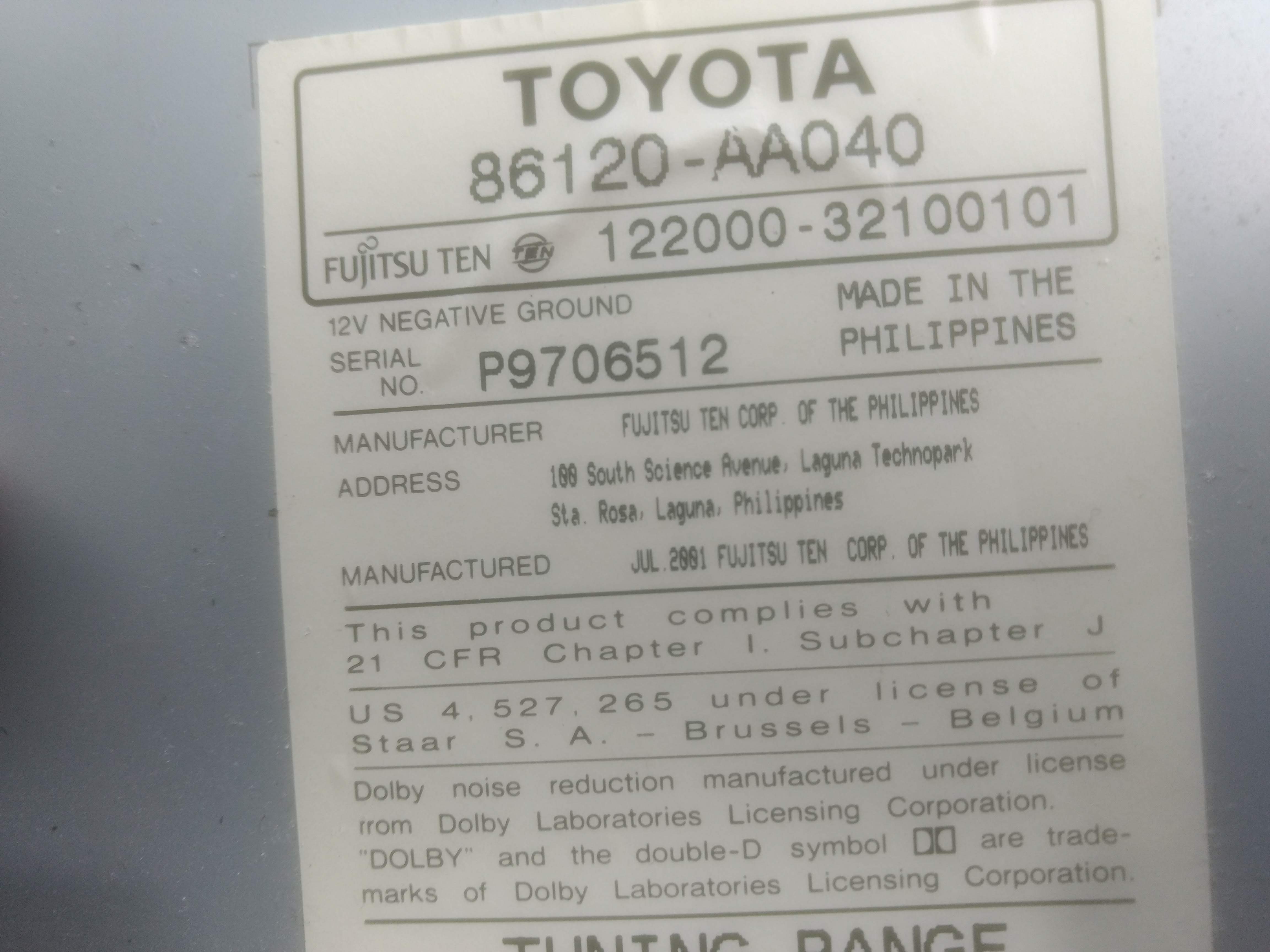

Old Jul 30, 2018 | 11:33 AM
If you have the old radio, post the model number.
Post a link to the harness purchased on Amazon.
Is the mute on?
The amp would located on passengers side of the glove box against the side of the car chassis or close to it.
The radio without amp does not have shielded cables on the harness plug. The radio with amp does.

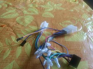

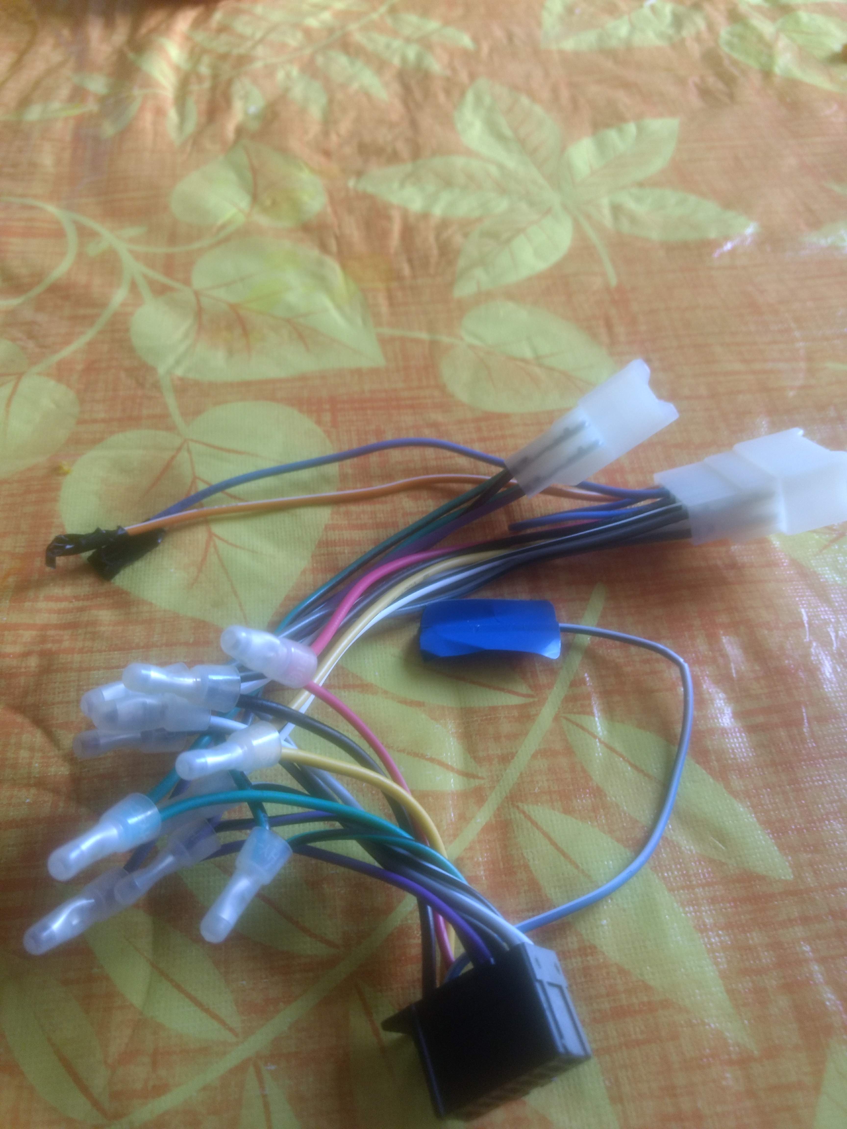

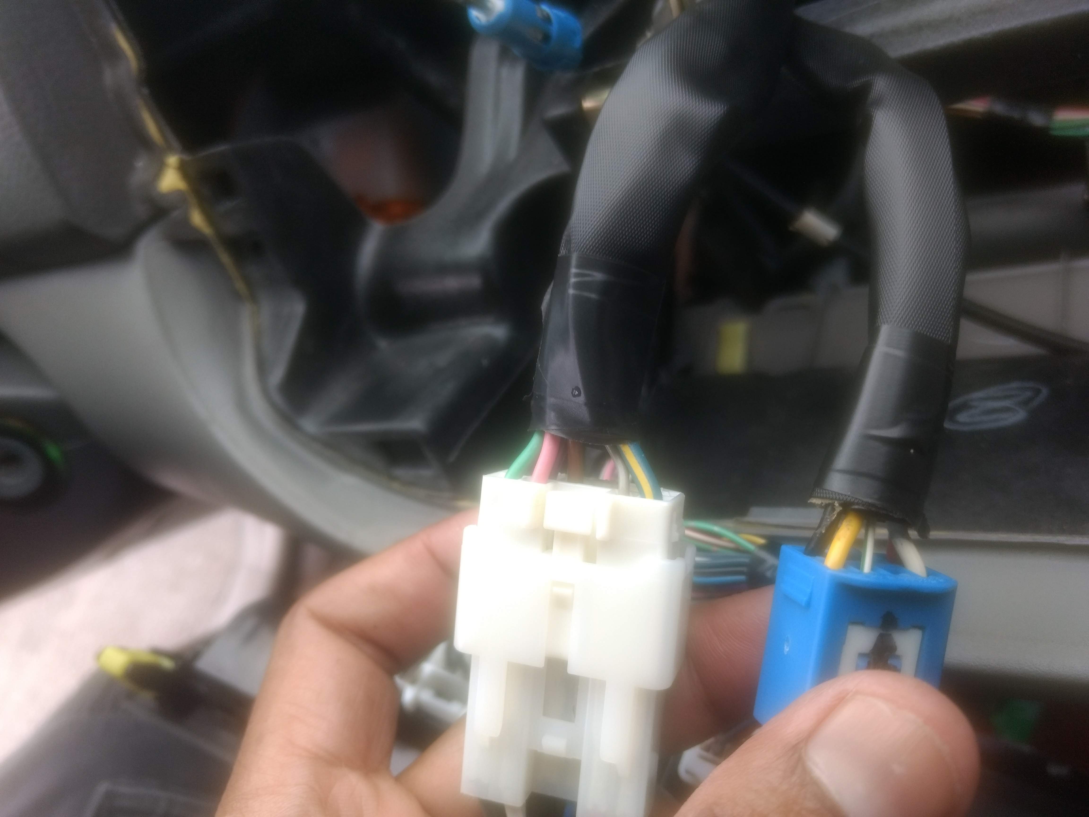

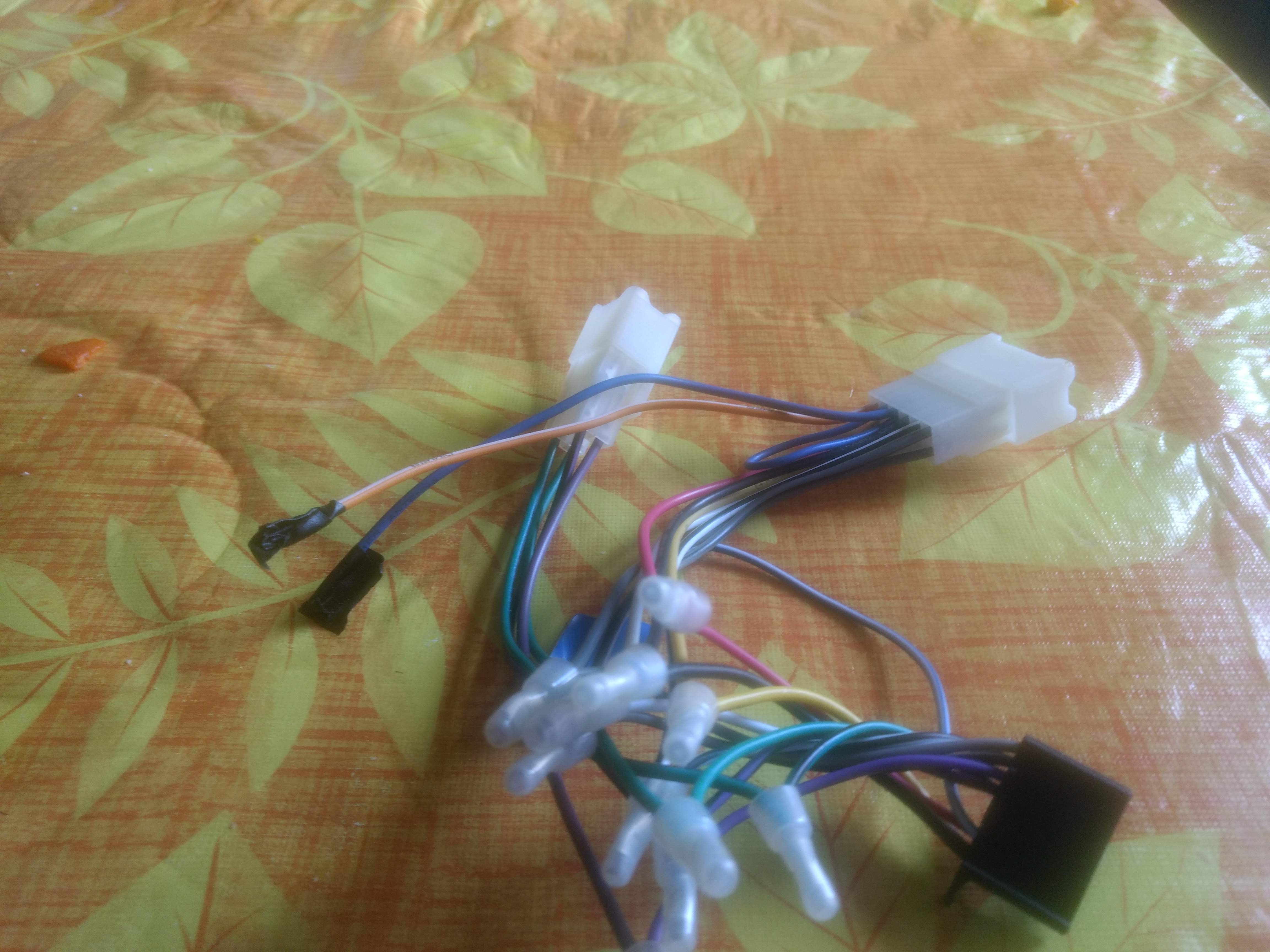

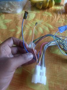

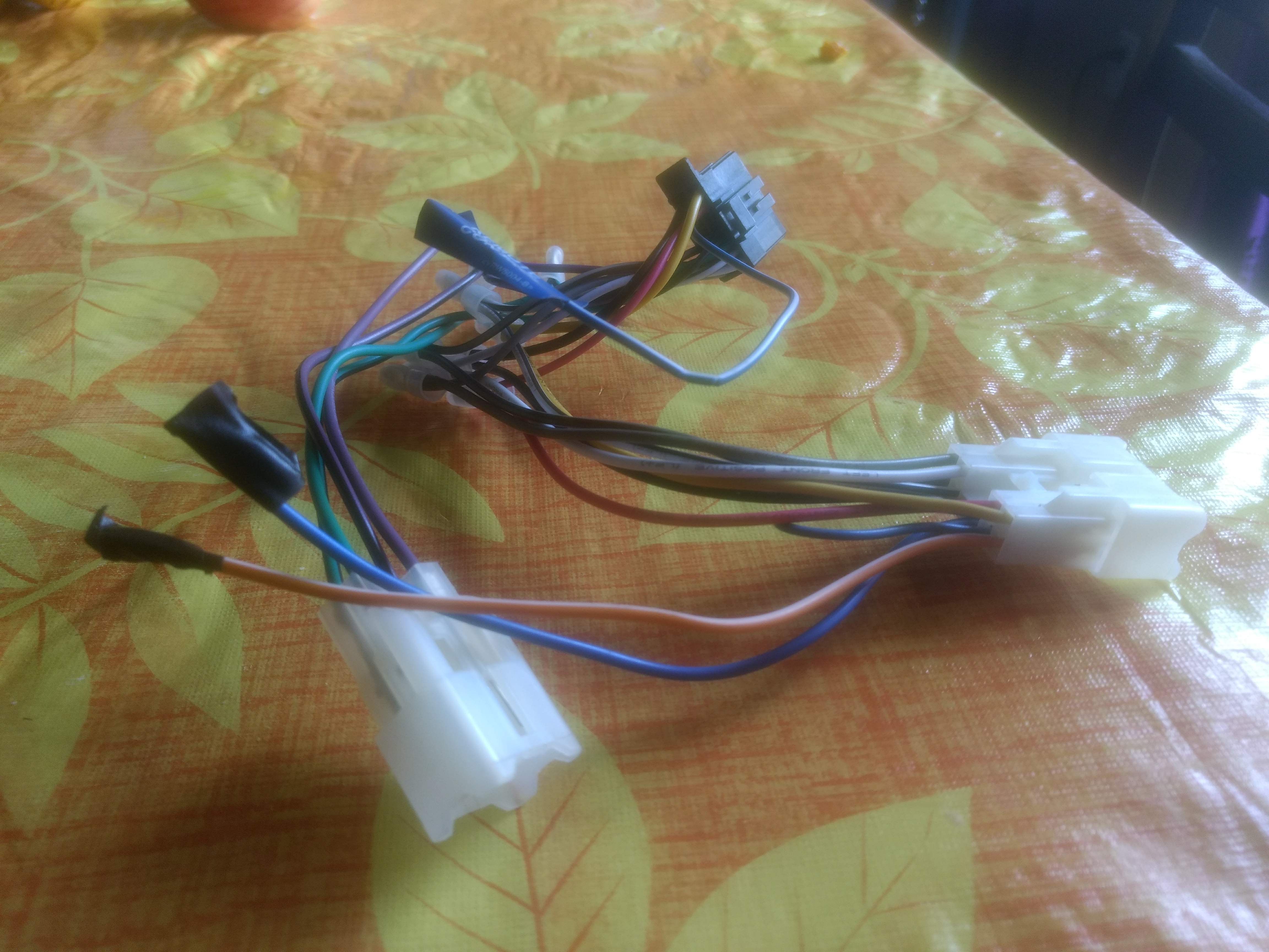

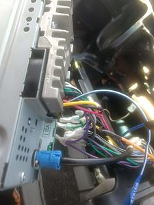

Smile Wondering is is the blue and orange wire with white stripe does?,
Wondering what these 2 blue and orange wire with white stripe does!!1, probably that's is the problem. Please explain.
Attached Thumbnails Camry 2002 LE Aftermarket stereo no sound-img_20180804_115945998.jpg   Camry 2002 LE Aftermarket stereo no sound-img_20180804_120030113.jpg   Camry 2002 LE Aftermarket stereo no sound-img_20180804_120057730.jpg   Camry 2002 LE Aftermarket stereo no sound-img_20180804_120115618.jpg   Camry 2002 LE Aftermarket stereo no sound-img_20180804_120117091.jpg
Old Aug 4, 2018 | 12:04 PM
What is this wiring?
Do the white plugs, plug into the radio and black plug into the factory harness plug?
Did the old radio have one harness plug and new radio have two plugs?
Did you splice the plugs together and if so what wiring reference was used?

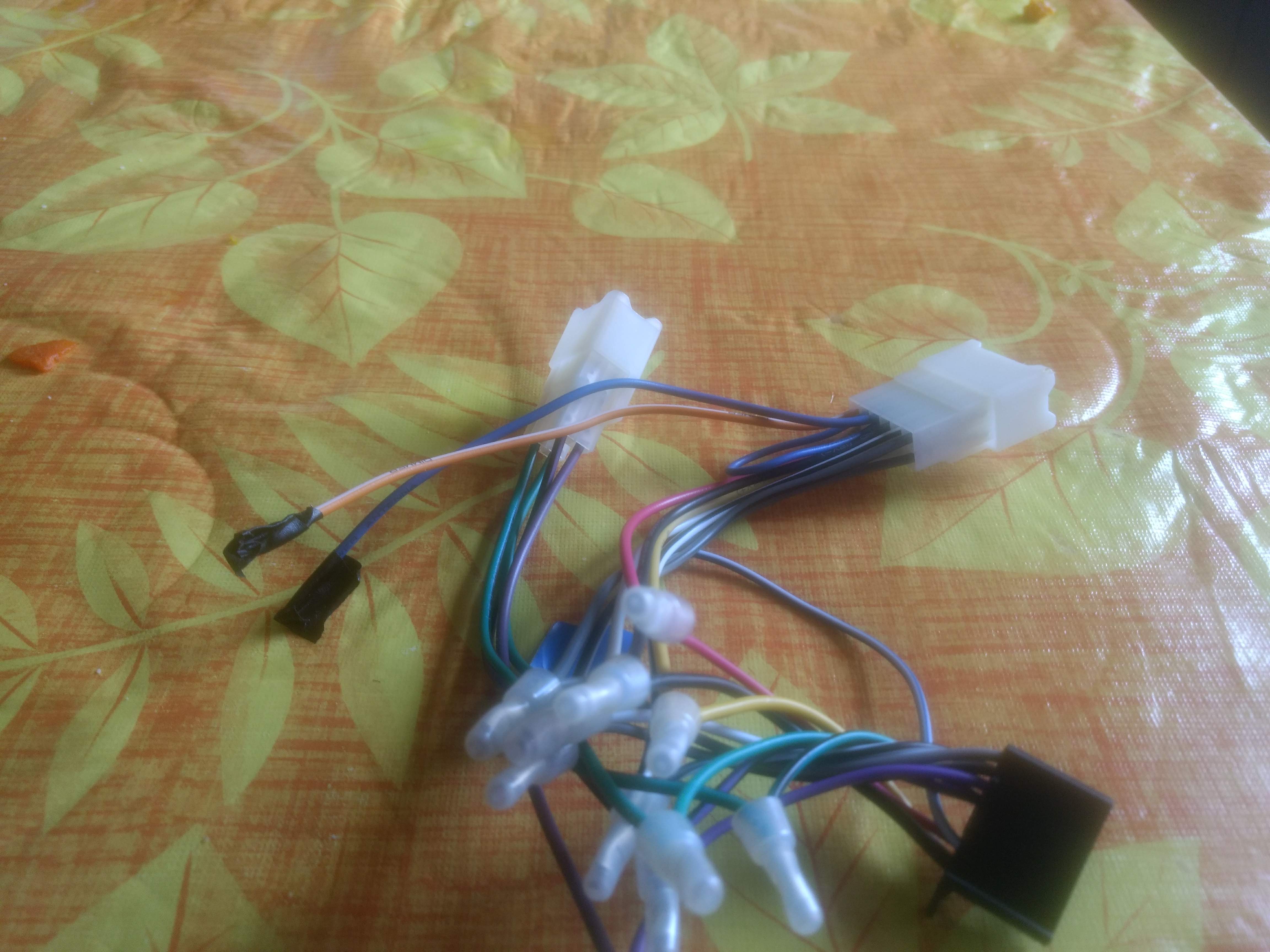

Smile Camry 2002 metra wiring harness
This the new metra harness which I bought from amazon.ca for my new stereo, my old head unit in my car had 2 plugs one blue and one white but my new stereo has only one which is the black pin which combines 2 white plugs. The solid blue and orange cable is left out I am wondering which one to connect.

Old Aug 5, 2018 | 02:16 PM
Do these wire color match yours?
Radio Battery 12v Blue/Yellow
Radio Access Switch 12v Gray
Ground Brown
Illumination Green
Amp Trigger Wire Pink/Blue
LF Speaker Positive Pink
LF Speaker Neg Violet
RF Speaker Pos Light Green
RF Speaker Neg Blue
LR Speaker Pos Black
LR Speaker Neg Yellow
RR Speaker Pos Red
RR Speaker Neg White
The harness is for a host of Camry years. Prior to having the antenna in the window it was a power whip version. :The radio had wires routed to the antenna motor to turn it on/off. These plugs would then also have these wires.
