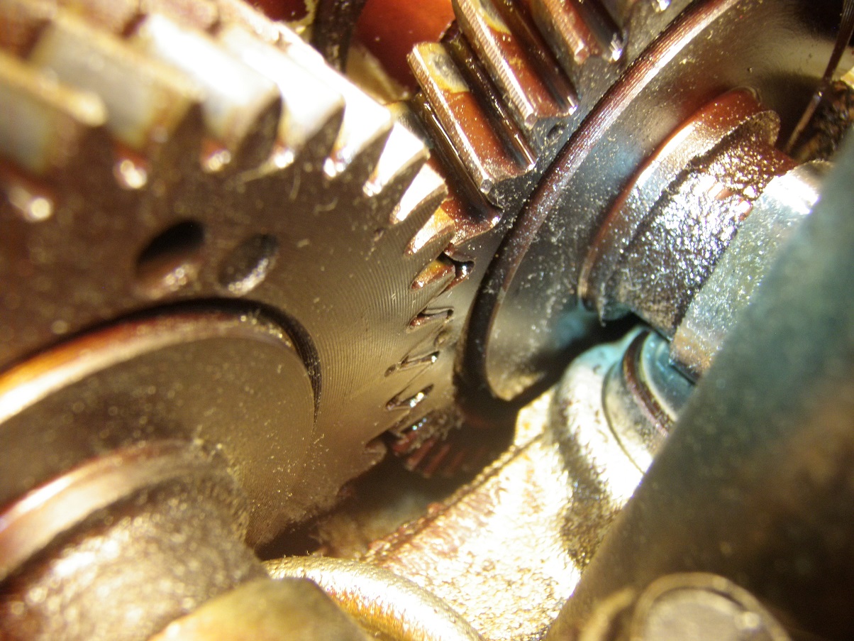

As I was tearing it down, I did make sure #1 cylinder was at TDC Both with a long screwdriver down the hole and the Balancer mark @ Zero. Once I got the timing cover and valve cover off, I carefully checked and marked where the Cam sprocket was, (took a peak thru the little hole at the top with a mirror and found a perfect match to the mark/dimple on the cam cap), as well as where the intake and exhaust cam gears matched, (there was a larger dimple on the intake gear which aligned with a smaller one on the exhaust gear), I put an etch across that spot just to be sure.

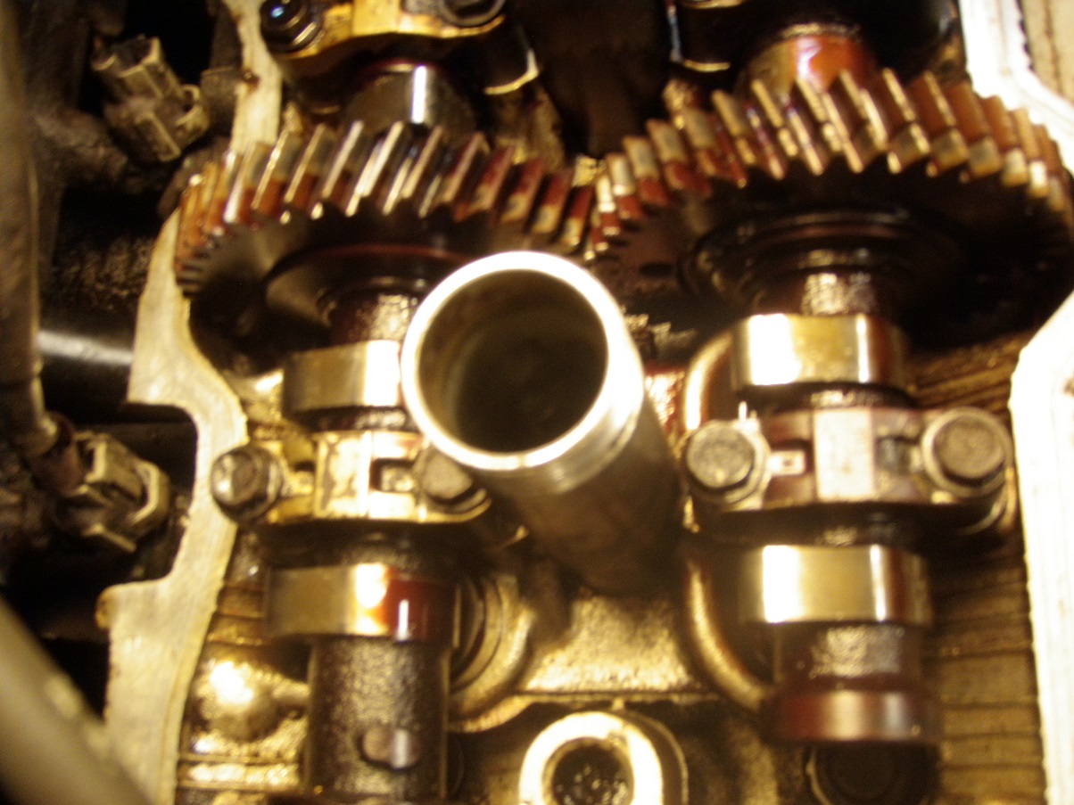

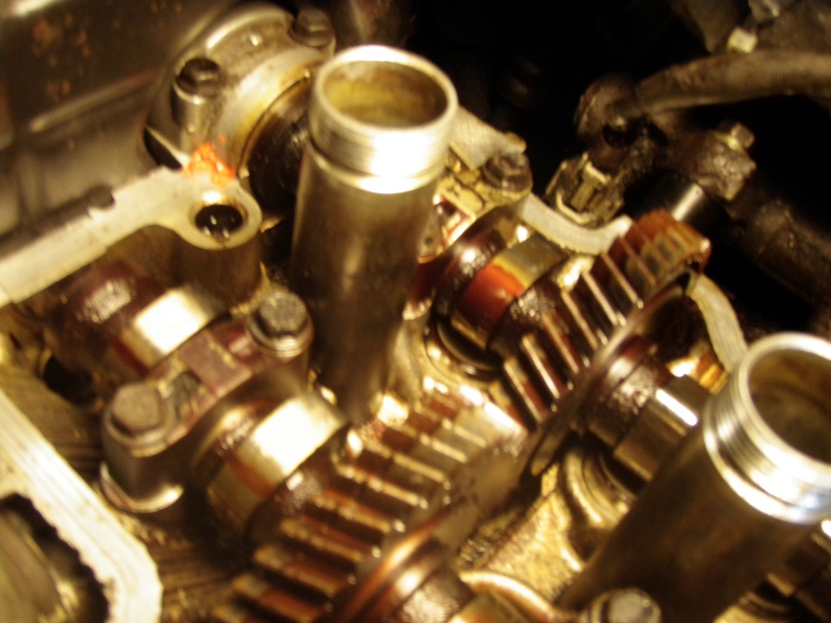

Below is a couple pics; first is of the lobe positions from front of the motor, second is from the radiator. You can see that at TDC my intake lobes have just closed and the exhaust lobes are on the way to closing. You can also see the dimples aligned. (I hand turned the motor 180 degrees from TDC and the exhaust lobes where straight down ...correct, right?
