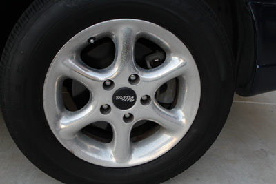

Anyhow, my family and I recently moved into a new home and come to find out we have hard-water here. Sprinklers and sun are not my best friend right now. I have(somewhat) successfully removed the water spots from the paint and glass. IE.. white vinegar, Nothins Better water spot remover, polish, claybar, wax, et cetera.
The issue I am having and need help with are my aftermarket aluminum wheels. I am using Eagle One - Never Dull, and I also use Mothers - Mag and Aluminum Polish, however, neither seem to work unless I spend hours scrubbing away at one area. I guess my main question is is there a faster way or do I just have to sack up and scrub away? You can see from the picture the area that I have already worked (2nd LH spoke from the top). That right there took me half an hour. I really dont want to spend 3 hours on each wheel unless I absolutely have to. I dont mind putting in the work, but if there is a smarter way, please let me know. Any help is greatly appreciated.

The hard water when evaporated leaves minerals deposits behind which you need to scrub off. You can investigate more methods to chemically dissolve the minerals (vinegar is one) rather the grind them off as you are doing with a clay bar etc. This means finding out from your water department what minerals are in the water (these minerals vary) then finding what products will safely dissolve them.
For washing your wheels, suggest buying distilled water or fill up jugs with low cost treated water from fill stations found at grocery stores (make sure this fill station water was treated by reverse osmosis).
Wash one wheel with hose water until clean then rinse quickly followed with the treated water perhaps from a low cost pump chemical garden sprayer available in the garden section at department and hardware stores.
The treated water having no minerals will wash off the hard water off leaving a spot free surface.
You can also use a shami to absorb the excess water on the wheel for faster drying times.

In the old days people used to spray hair spray on aluminum dirt bike rims. This provided a thin shield against corrosion. Perhaps there is something that can be sprayed on the wheels to form a barrier against the minerals firmly attaching to the metal making them it easier to remove.
