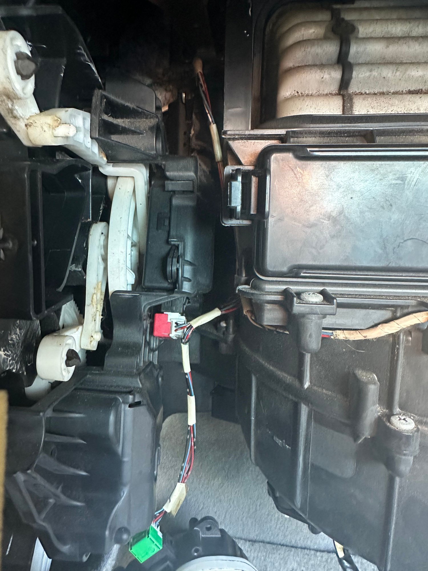

Yes, but the blower assembly appears to be in the way to remove it once the screws are removed.

If the motor is the only bad part might review this procedure. Its radical but apparently it works if the motor is the problem.
https://www.camryforums.com/forum/ec...c-50649/page2/
