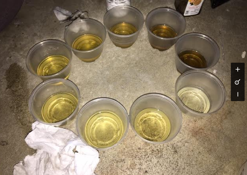

I just started my brake fluid replacement (it's been 8 years since last replaced). I began by replacing the reservoir fluid with new. I've only done the right rear, and I've pushed through about 22 oz of fluid, and it still didn't come out clear, although it became much lighter colored. In the picture, the lightest color fluid is fresh from the bottle. I don't get how it could still not be perfectly clear fluid after pushing that much through. What's going on?

Don't know.
I suggest bleeding the other lines in order of distance from reservoir and calling it good.
