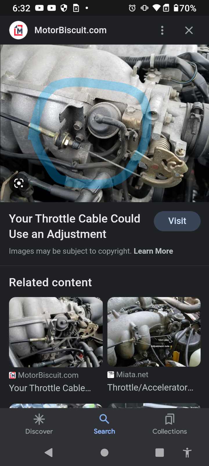

Default Throttle body
Originally Posted by Spidop13
I recently had to jump my 2002 xle battery unawares I put the jumper cable on wrong and drained the battery, I fixed the cables and got the engine running but the accelerator will not work a coder told me the throttle body circuit malfunctioned so I got a new throttle body and the accelerator still won't work any suggestion?
Throttle body
Try to tighten throttle cable just enough to be snug.
