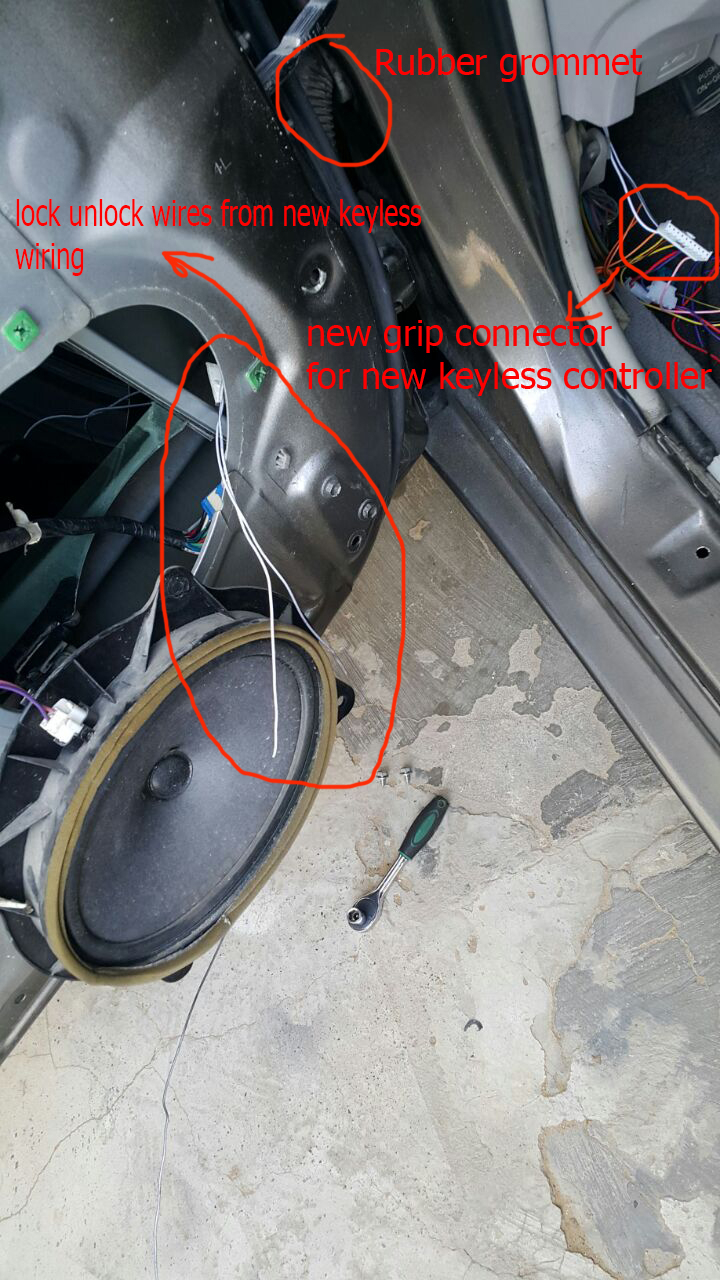

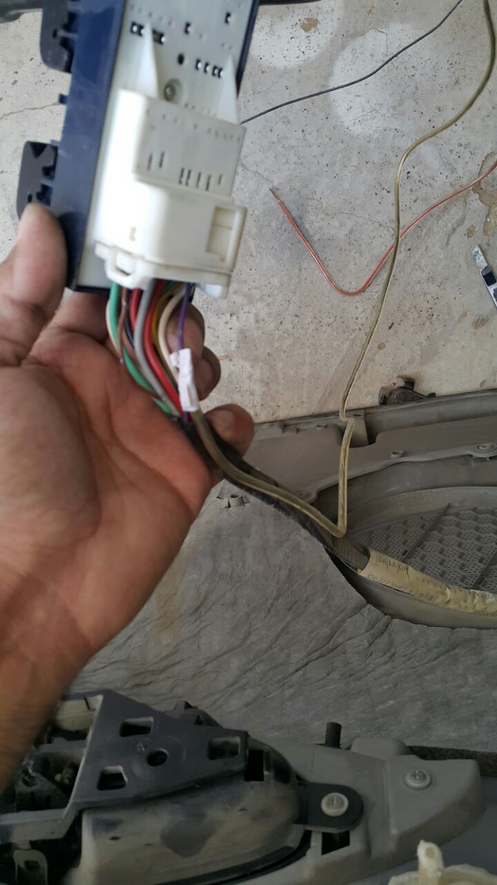

open driver front door panel
go to the windows controller

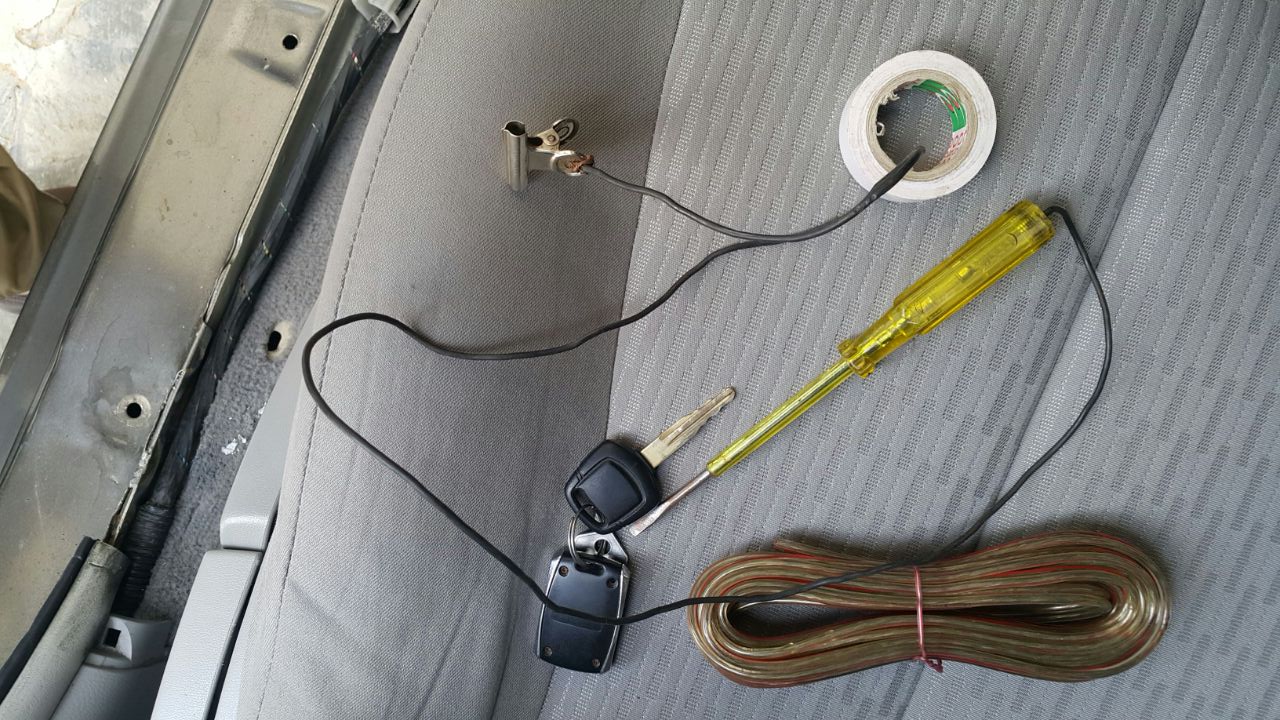

take a tester light for dc ( One with earth and a tester light)
connect the earth to any good ground
and touch different wires at back of the clip.just push hard enough that tester end can touch wire end ( Don't remove the grip/plug from controller)
in my case purple with silver dots was for locking and brown with silver dots was for unlocking ( when you touch the wires you will see the action its doing. And on my new key less controller diagram it had white for lock and white with black was for unlock
keeping the plug for controller to the inside of the car remove driver side kick panel and feed these two wires from your new key less controller for locking n unlocking through the rubber grommet into the door . Remove the speaker for ease to check for cables from grommet in door ( use hanger straight it out tape both wires n feed through grommet take your time )
Extend the lock unlock wires from new connector cause they are not long enough and later you will have problem ( while positioning the controller short wires will now allow you to move it further under steering column)
add fair amount of length to both i used speaker wires didn't had any other wires at that time
strip little bit of wire after the controller and join lock wire from new key less to it and tape it similar for unlock . in may case purple w silver to white for lock and brown with silver to white n black for unlock.

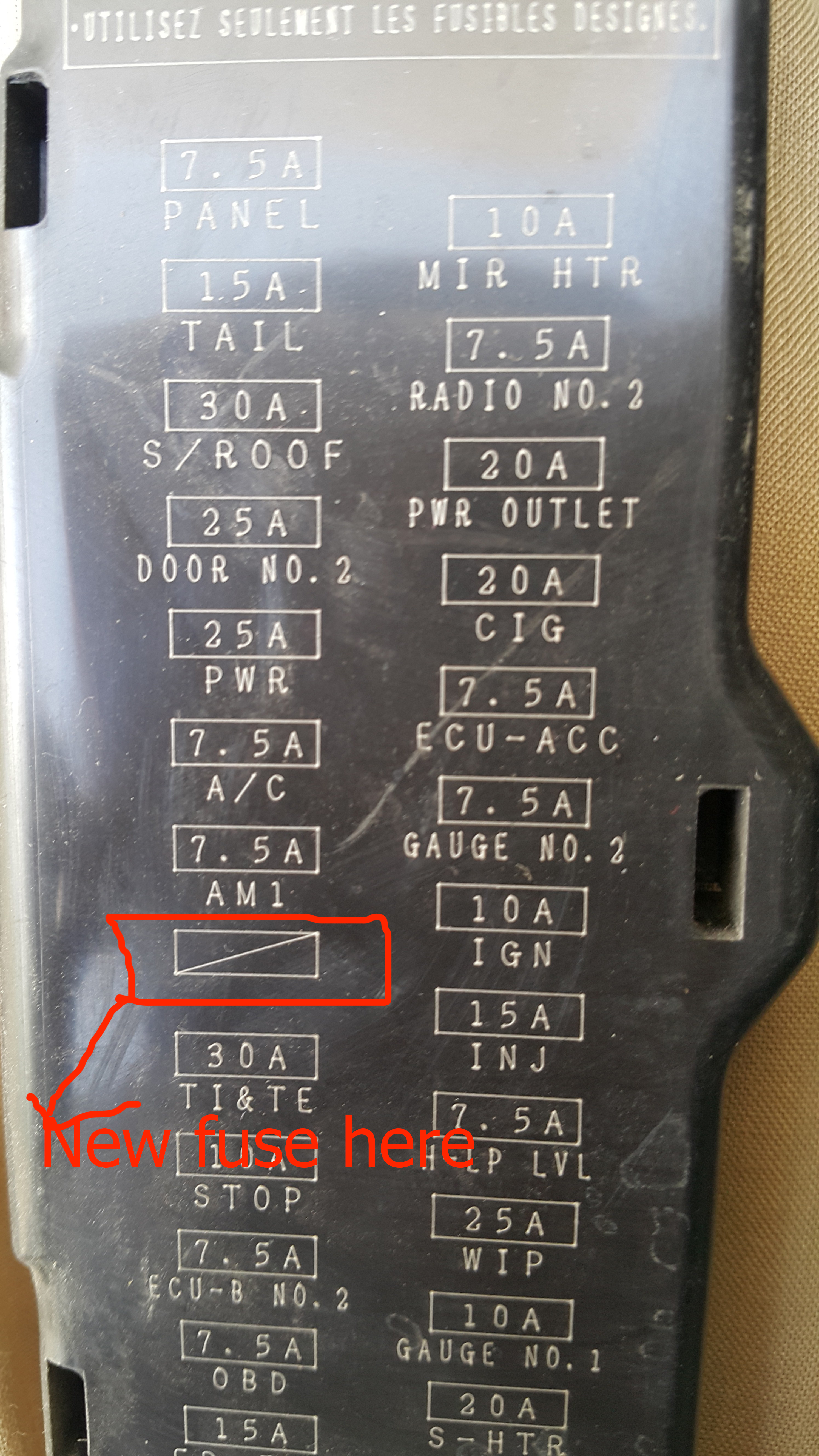

Attach red wire to any empty spot on the fuse box under steering column add any fuse preferable 15A to empty spot

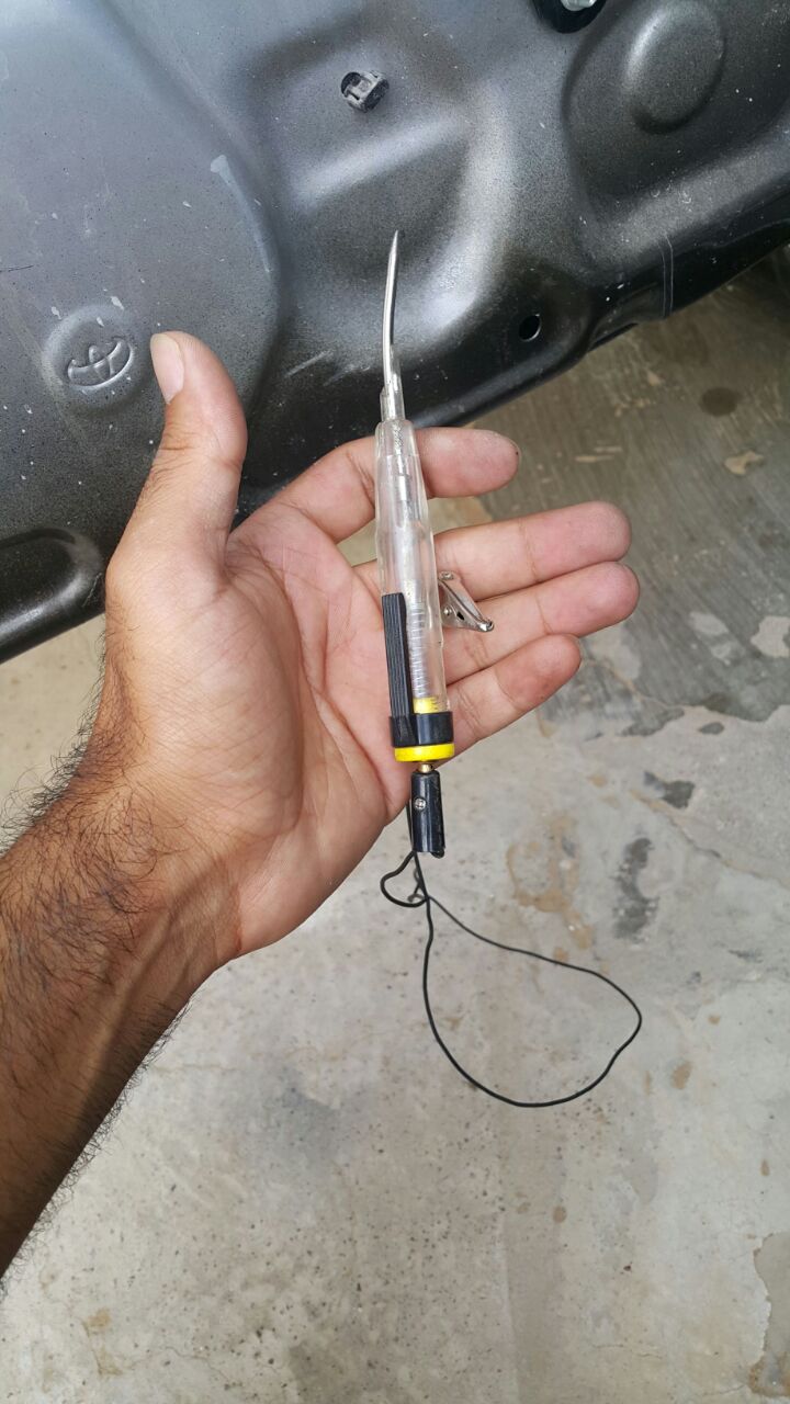

just test first the current flow side by using tester>
tester one end to earth other end to new fuse. one end the side on which the will allow to tester light up is where you will add red wire with
Just strip wire end of red and wrap around an put fuse in wrap only to one side of fuse from where current flows as tested using tester. just force fuse in gently.

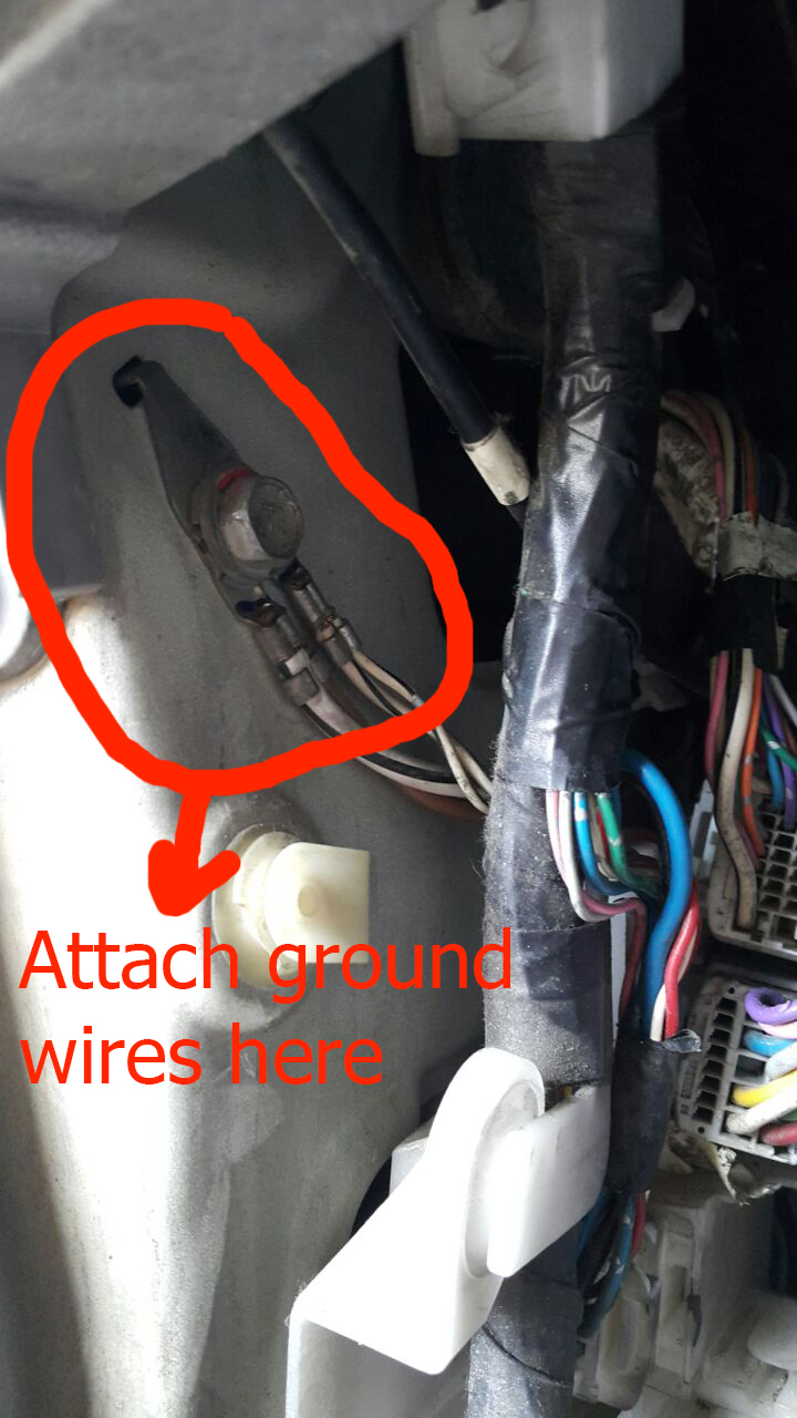

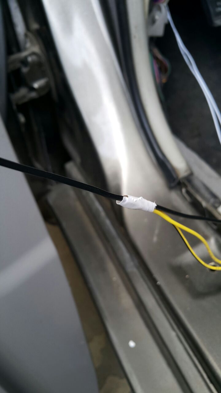

In my case had three earth/ground wires one main one for lock one for unlock
black, yellow-and yellow-black
Attach yellow and yellow-black to main black and that black to any ground inside kick panel

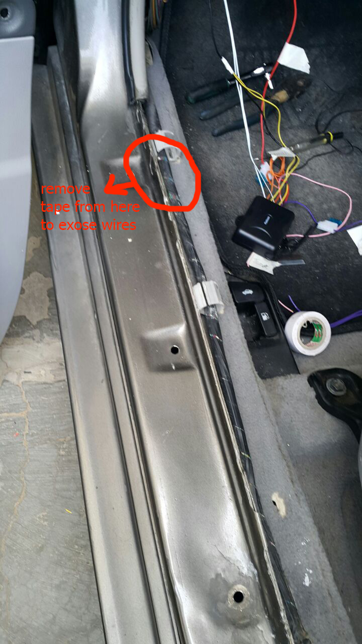

yellow on left and green for right just check your both turn signals in trunk
there is a wire loom going from kick panel to the back just with the frame
remove the tape as close to the kick panel as possible keeping in mind you have to make connection
turn on your double indicator or emergency lights hazard lights or what ever you call them, take your tester one end to earth strip same color wire as u checked in trunk. connect other end of tester to stripped wire
your tester light should start blinking with the indicators. connect any one signal wire from new wiring to it and do simple for the other one tape them . extend if possible before making connection to them.

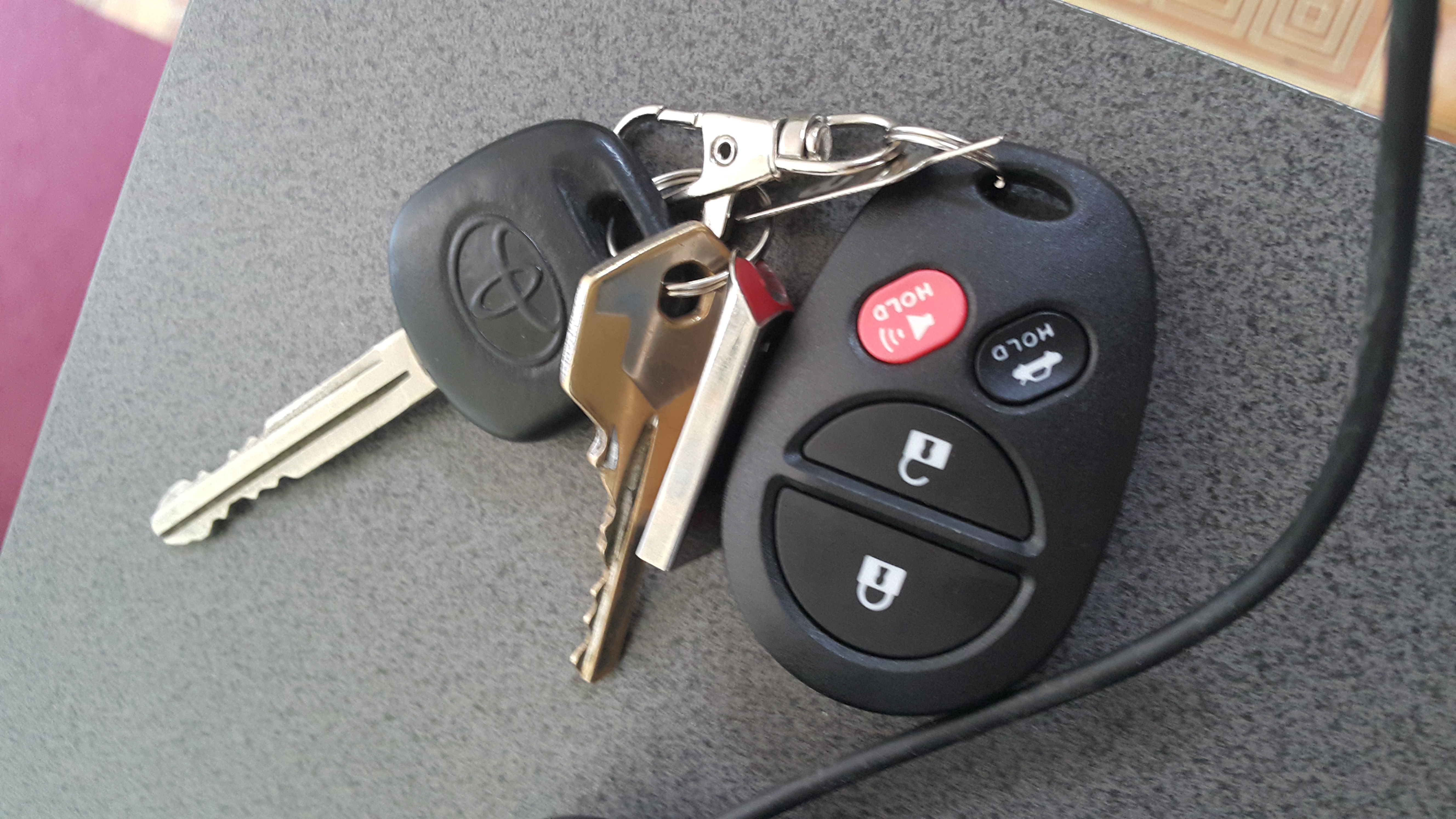

and here is my remote or keyless what ever
