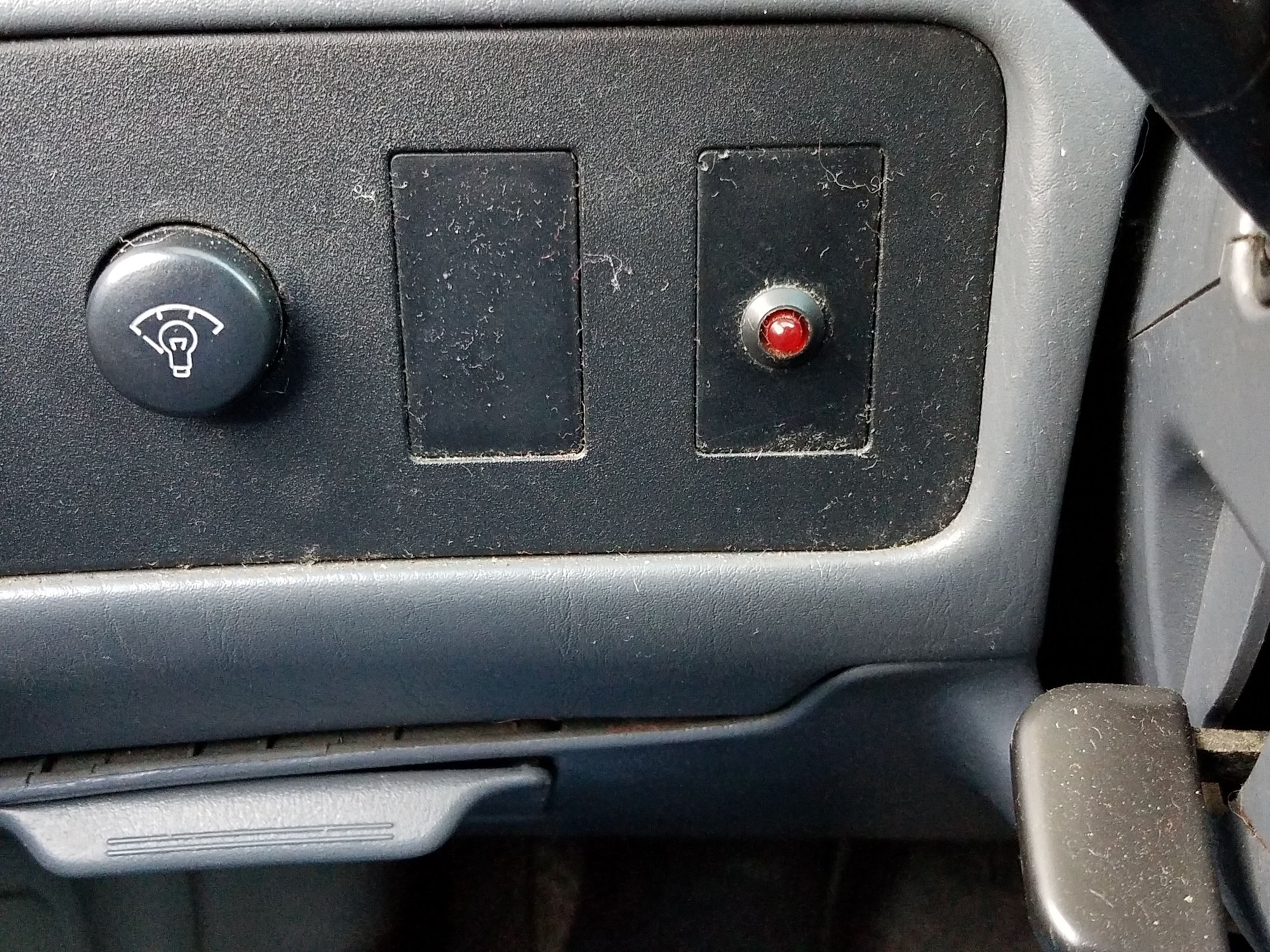

This is where I am at. I replaced all the relays and checked all the fuses and still nothing. I did notice if I flashed the high beams the low beams are the ones that flash. I can only do this with the lights in the off position. So it might be the integration relay you mentioned. Second, there is a red led light on my dash right next to the dimmer switch. It looks to be a factory installed as it fits perfectly into the dash. Could this be a possible reason for no high beams? Or could the stalk be bad and is not activating the high beams. Heck not even the blue light on the instrument cluster comes on.
What's this red LED light for??
