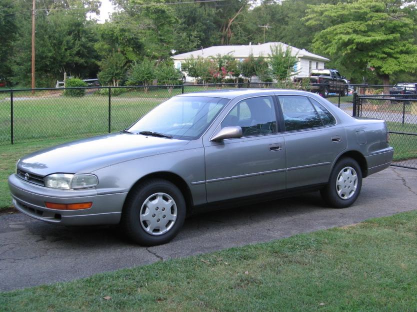

Hey Y'all from Georgia. I just bought a beautiful (to me anyway) 92 camry with the 2.2 4 cyl with 147k miles. Runs like a top, however it did sit in a garage for a good part of a year as the owner passed away and the son is just now selling her belongings to settle estate. The car had been started on occasion and driven around the block.
I am big on preventative maintenance, and have not owned a toyots since my 1973 corolla back in the 80's. I know they are easy to work on so Friday I drained the coolant and flushed her out with clean water 3 times. I then replaced both radiator hoses and filled her up with fresh new coolant. I let the car run for like 45 minutes to make sure new coolant got in block and heater core and everywhere it should. It was like new. I let it sit over night and had to start it sat to move it down driveway.
This afternoon, I started it and drove it about 1 house down the street and started to hear a very loud banging as if the engine was fixin to blow. I stopped and could not find anything obvious so, I got it back in the carport of my house and the thing was banging bad. I took radiator cap off and system was full of coolant. I decided to turn it off and after I did, I noticed ALL of the coolant was starting to pour out from the bottom as if water pump blew.
My question to you all is, what the hell happened? Do you think the new coolant screwed up the water pump? It ran fine for 45 minutes when I changed it and fine for the 2 min I had it running yesterday. I did check the oil and it is full as normal so I am thinking it has got to be the pump.
