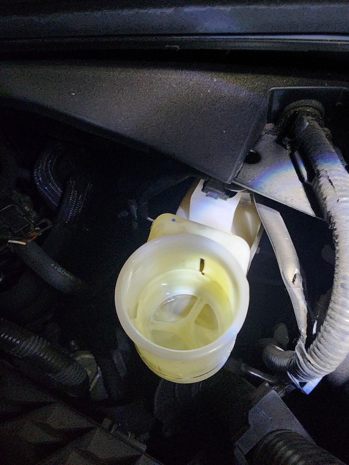

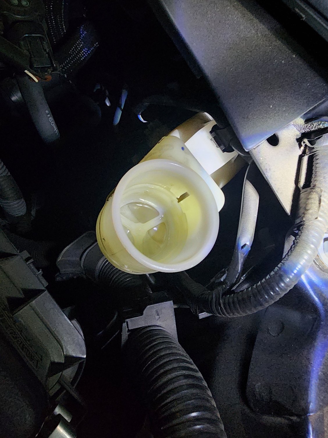

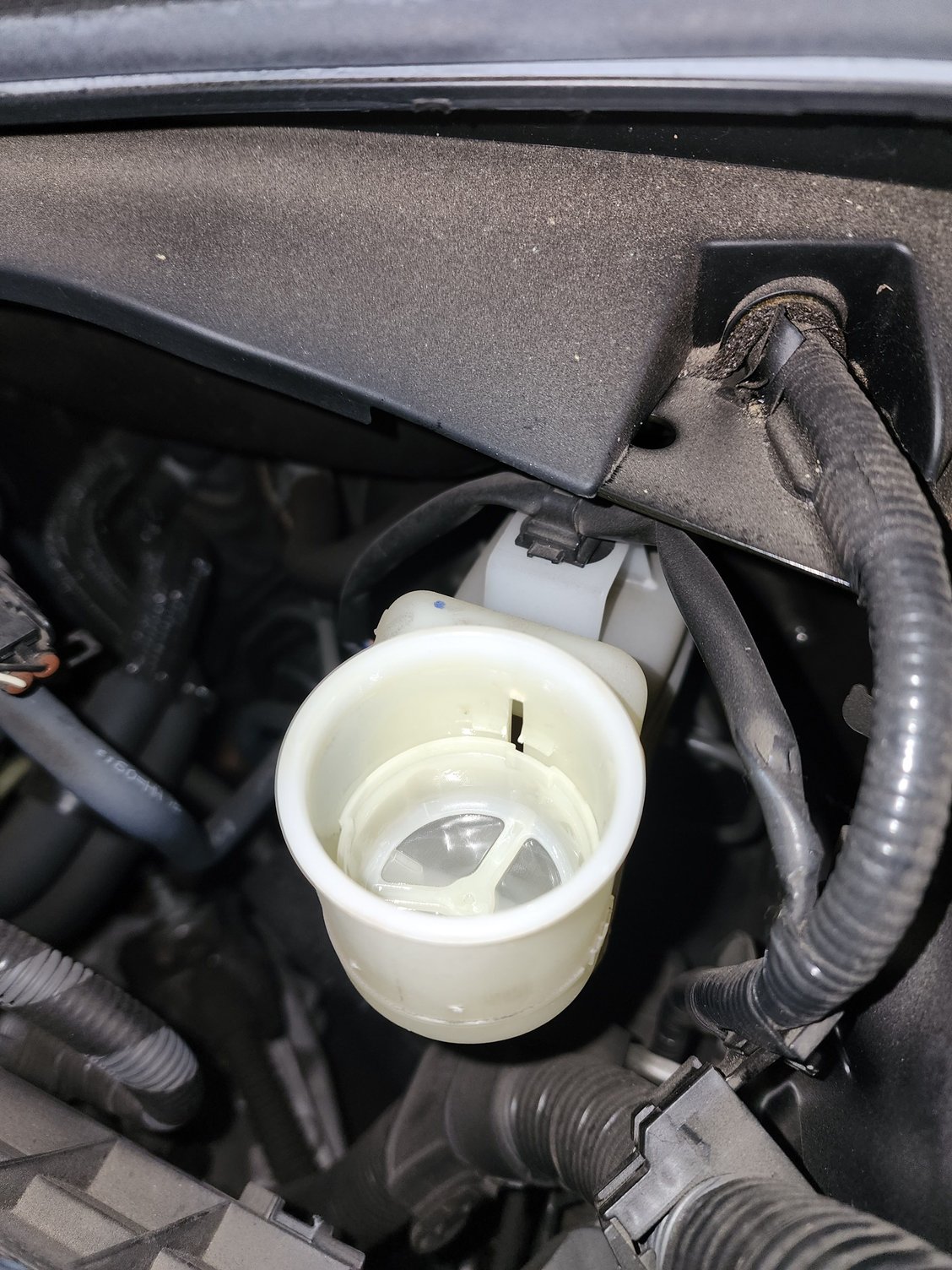

Bought a brake fluid tester and want to test my brake fluid. When I open the top of the brake fluid compartment, there is some filter preventing me from submerging the tip of the brake fluid tester into the brake fluid. I put on some gloves and tried removing the filter, but I don't see a good way to do so.
Do I somehow need to remove that filter to do the fluid test? How do I do that?

The tester appears to measure the electrical resistance of the fluid via the two probes. The more water in the fluid means greater electrical continuity.
You need only have the ends of the probes in the fluid. The fluid looks like it is touching the bottom of the screen.
The fluid looks great! The more moisture in the fluid the darker it gets. Brake fluid can become very dark to the point of being black.
Get a small bottle of the right kind of brake fluid and compare color. Place your probe in this fluid to get a reading for new fluid and compare with yours.
See link below.
Brake Fluid Color Chart: Find Out What Each Color Means
Most car owners never change it!
I would defer on changing the fluid myself as not needed based on your photos.
I think you're probably right but I don't have a great way to validate this. It could either be not enough fluid to measure, OR my fluid has no moisture.
Thinking you're right about this fluid being good.
I think my plan is going to be to (eventually) get some fluid, top it off to just under the max line, and then test the moisture content over the next few days/weeks once its more uniformly distributed. Looks like its pretty inexpensive (< $4.50 for a bottle).
