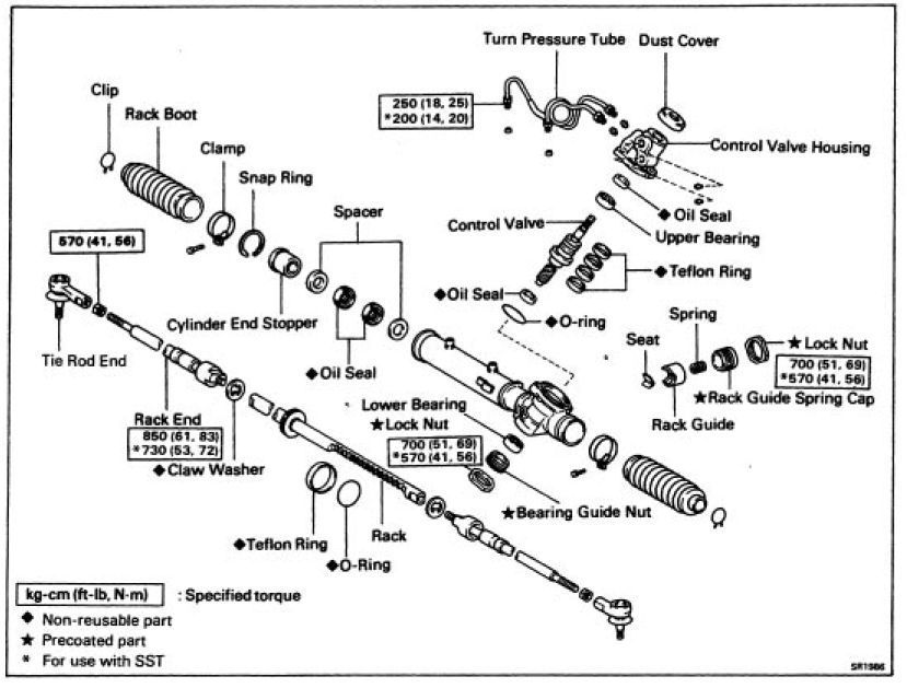

this is your power steering rack ---- seals and 0 rings like to leak
