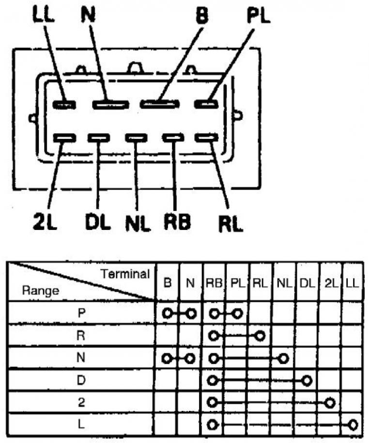

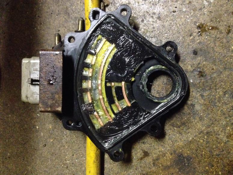

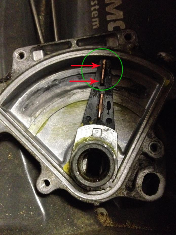

I had the same problem no Reverse lights or R lighting up on my shifter. I have a 1993. It was a problem with my Neutral Safety/Backup Light Switch. See attached pictures of the problem areas. What I did was sanded the one bar down that had the grooves to make it flat again. Then use like 1000 grit to give it a smooth finish. Then use the electrical grease it all up.
Also don't worry NO transmission fluid will come out when removing.
Also attached is the diagram to test your switch.

Is the problem the Neutral Safety Switch? Will trans fluid leak out when I remove it? Can the NSS be opened and cleaned or must it be replaced?
Is a replacement NSS basically a plug and play unit or must it be adjusted. Does the car have to be in neutral or park when replacing.
Bulbs on each side were checked and are in working order. Thanks in advance for the advice!
