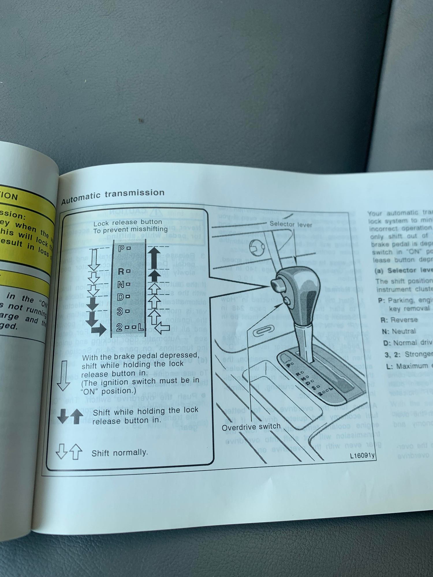

Page 112 of the owners manual has some info.
To move the gear shifter for Park, the side shifter button needs to be presses AND the brake pedal pressed.
To move from Neutral to Reverse the side shifter button needs to be pressed.
Your shifter seems to have a problem with the side shifter button lockout not working.
The brake light lockout is a different locking system the side shifter button lockout.

Default UPDATE, half issue solved.
Hello Joey! So i apologize for any confusion. But I reviewed my issue on a step by step level in accordance to the owners manual. I have attached the manual you described.
Through my efforts, I found out that the lights on the shift **** i use with my hand say they're changing gear from R > N, N > D, and vise versa. The shifter assembly just doesnt exactly line up with what the lights say on the dash but that's just because it is a sliding piece of plastic telling me which gear i am in.
Therefore, ALMOST everything works as it should in accordance to the manual. I say almost because my concluding issue is that when the car is in N, it can go into Drive or Reverse WITHOUT pressing the shifter button lockout mechanism. This is the issue cause according to the manual, I should have to press the lock release button in order to get the car from N to R. SO, that is the only issue and it could be now narrowed down to that specific part.
Thanks for everything!
Old Sep 15, 2022 | 02:03 PM
That is the page.
One can take the shift cover off to a look. Search under changing the light bulb for the gear shift letter illumination.
